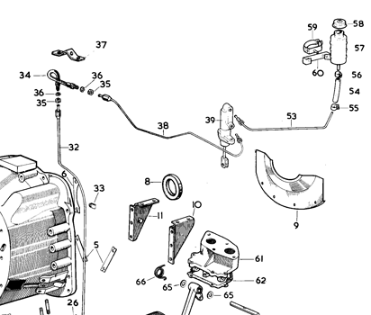

Postby 340jag » Thu Jul 27, 2017 7:38 am
Diagram is the S-type lay out !
