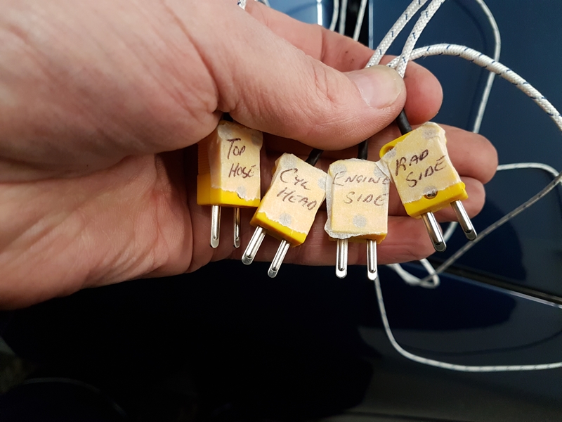

So, today I've been trying to measure the temp during warm-up using two k-couplers hooked up to a temp reader. However, I'm not sure of the validity of the results I'm getting.
Therefore, I wonder if someone who understands the precise component locations of the AJ16 engine could give me some opinions on the following:
- Is it realistic to tape the k-couplers on the thermostat housing, one on the engine side ie right by the sensor, and one on the curved surface just on the rad side of the housing? Or will I get thermal dissipation across the alloy of the housing such that the readings appear to be similar even if the stat was shut during warm-up?
- Would I expect the top rad hose to warm-up in the first 5 mins of idling if the stat was fully shut, i.e. is there some inevitable thermal dissipation into the top hose when the stat is shut?
- How different would I expect the readings to be if taken on the outside surface of a rubber rad hose compared to the external surface of the alloy stat housing?

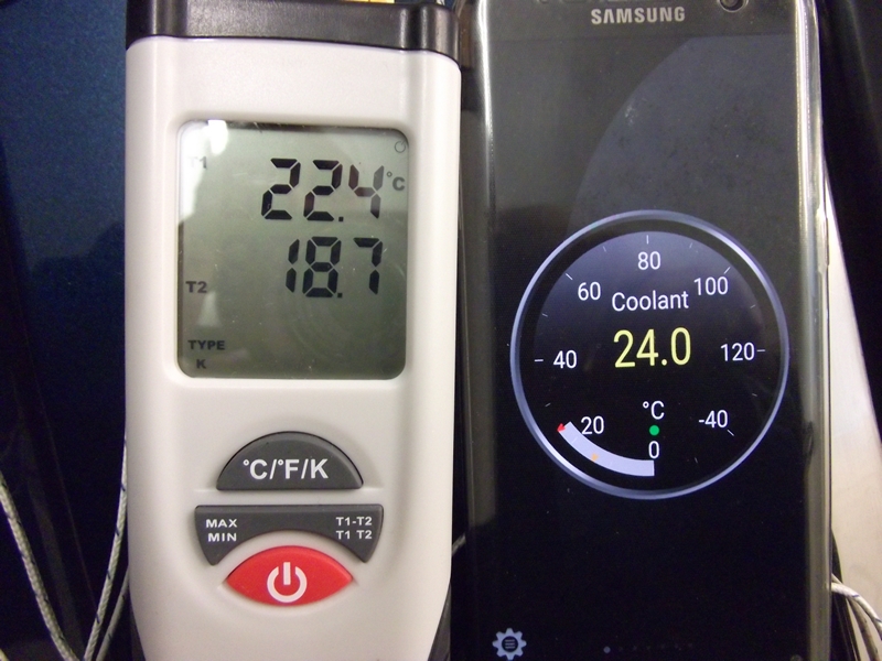

I ran some more tests today but still not sure of what it's telling me. I started off by wiring up 4 k-couplers to both sides of the 'stat housing, the top hose and the cylinder head. I only have a 2-channel reader and wanted to monitor the 2 sides of the 'stat housing but also wanted to occasionally x-reference the top hose and the cylinder head:
I then fired up the engine, ran the aircon to speed up the process (Annoyingly for the 4th year running, my aircon isn't very cold!) then connected my OBDII plugin so I could monitor the ecu-read coolant temp also.
The two readings on the meter represent the engine side of the 'stat housing followed by the top hose side of the 'stat housing. My phone shows the actual coolant temp as read by the ecu. This is also from the engine side of the 'stat housing. There was a differential between the two halves of the 'stat housing but the top hose side did seem to be heating up immediately from start-up. don't know if that's from a partially-open 'stat or should I expect that from the bypass of coolant through the "jiggle-hole"? As the engine temp increased, the differential remained broadly proportional and the coolant then reached 82c.
The top hose side of the 'stat housing was starting to get a little closer in temp to the engine side of the housing and I expected them to suddenly equalise as the 'stat fully opened but that didn't happen! The coolant temp didn't go any higher than 84c after 20 mins of running the engine and the temp gauge didn't go much higher than about one quarter up the scale.
I suspect there may be two problems: a 'stat that is partly open all the time and which never fully opens but still stops the engine from reaching full operating temp. And also a gauge that should be reading a bit higher even at only 84c. And of course, there's that pesky aircon which probably needs regassing and a leaking seal replaced!

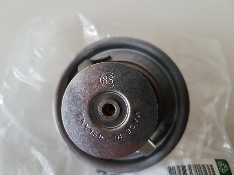

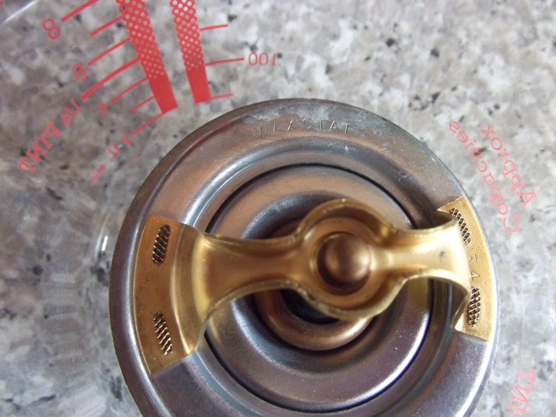

As I mentioned, I fitted a new 'stat yesterday morning. Thanks to Mark at Guy Salmon who opened up at 8am so that I could collect my parts and get them fitted before I had to leave home at 9.30am
With the stat housing cleaned up, the new 'stat and a new seal fitted, I started the engine. Within 7 minutes it warmed up straight to an ecu-read 93c, dropped to 86c as the new 'stat opened and then sat and cycled continuously between 86c and 91c. Very different to before! The temp gauge now sat much closer to the mid-point. I checked for leaks then left to watch Chelsea beat Tottenham, Oh yes!!

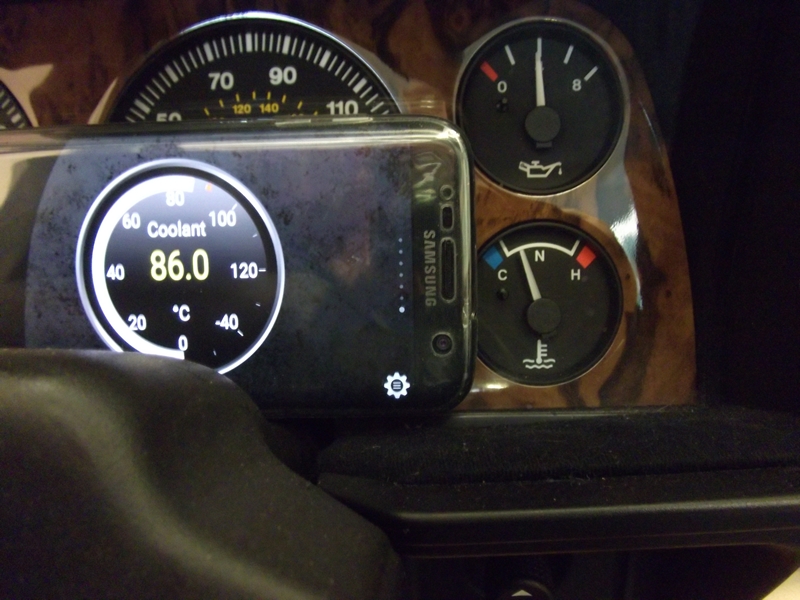

Today, I went out on a 100-mile drive with 120 Triumph TRs, great drive! At 50mph the temp cycled continuously between 87c and 91c. At 75+mph, it cycled continuously between 90c and 93c. That's about what I would expect. The temp gauge also sat just fractionally under 1/2-way which is where it used to be a year ago. However, at idle, the gauge drops a bit as my minor gauges do under-read at idle so I probably have the usual slight earthing problem either at the bulkhead or at the instrument cluster. One more thing to look at.
So that should be the problem solved with a partially-stuck open stat replaced. But....this afternoon I looked at the old 'stat. It was definitely closed after I extracted it from the car. Obviously, during the job, I removed and discarded it quickly to avoid too much coolant loss. But it was definitely closed when I picked it up off the floor. So, I put it in some 90c water and it opened! I tried it 4 times and it worked every time. If you look closely at the second pic you can see it starting to open:
So now I'm confused. Did it get stuck open in the car, freed itself as I removed it and is now working perfectly? Do I have a working spare to keep or should I bin it? Who knows?!

Thanks for doing that. It was very good of you. As you have noticed there is approximately a 16 degree difference when the outside alloy of the stat houses reads 70c compared to the coolant temp inside.
Your readings seem to indicate two things:
- That your 'stat started in a closed position and opened close to 88 degree coolant temp as expected.
- That the natural heat transference and bleed valve mean that the top hose does start to warm straight from cold although mine was obviously warming more than yours, implying a partially open 'stat.
