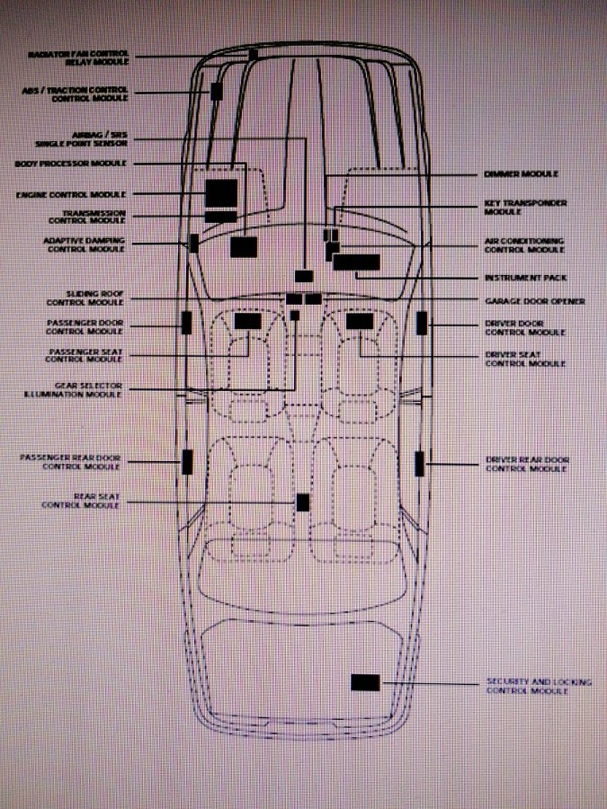

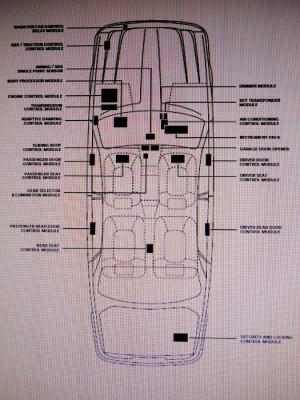

Hi Guys
Where do I find the Security Module on my 1999 X308 XJR please?
Bruce
Andy P
Posts:960
Re: Security Module
Postby Andy P » Tue Oct 09, 2018 3:28 pm
Hi Bruce,
The security/locking module is in the boot between the battery and the rear of the car.
If you would like the PDF Doucument that came from PM me your email address and I will gladly send it to you.
