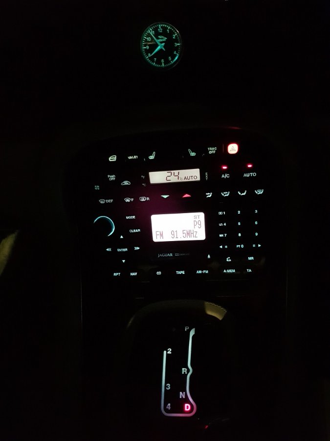

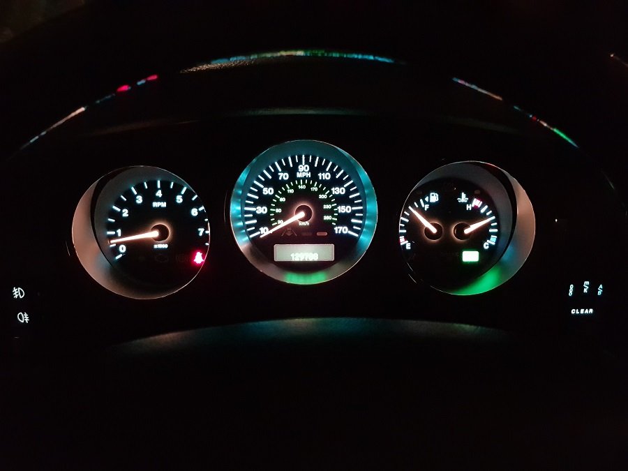

Being that I work evenings into the early hours of the morning I'm always impressed with the illumination of all the buttons and switches when I switch on the lights.Which you don't get to see so much during the day time hours.
Especially the J-Gate,the whole package just looks so wonderful to me :D
By the way they are all original spec bulbs,not LED's

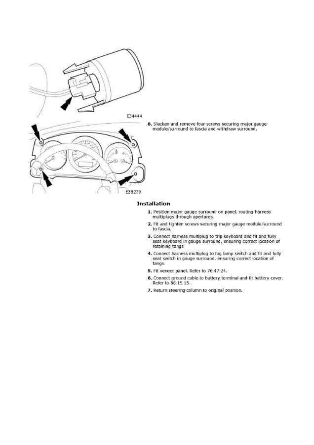

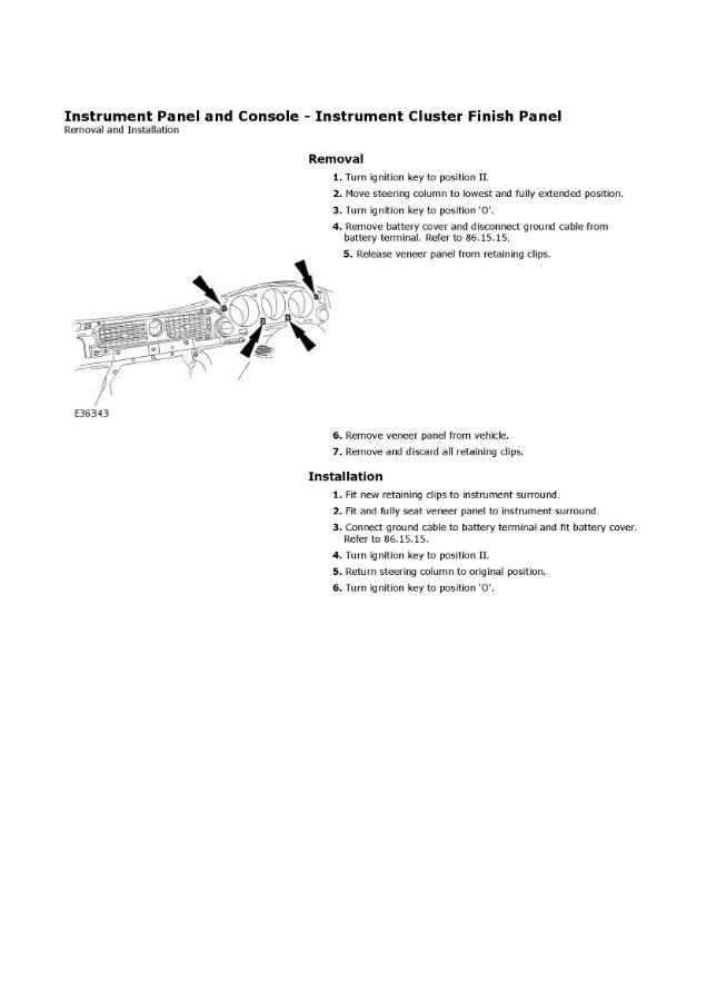

Hi David,
It's not too bad to do yourself.
This is taken from the workshop manual.
They make it sound simple :D
Instument Cluster Removal And Install
I use plastic trim removal tools when taking trim off,which helps not to cause any damage.
When pulling the cluster forward there are two wiring sockets that need to be unclipped if I remember correctly,one each side.
It's been a while since I have done it.
Hope that helps and good luck.
