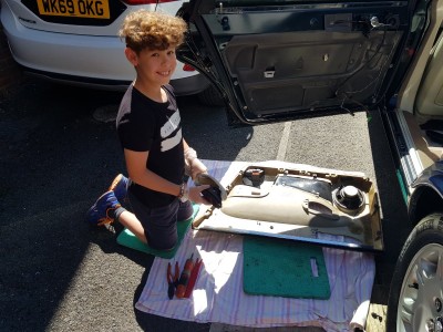

Picked up some interia veneers taken from a 98 Daimler for my 2000 Sovereign a few weeks ago.
After a clean up and a good going over with my polishing mop to remove some scratches it's all looking pretty good.
Grandson Rupert came over today and helped me with the final peices of the swap.
We took the door cards off and did the window switch veneers and ash trays.
So much easier when you have little fingers :D .
Looks great with all the Daimler Veneers.

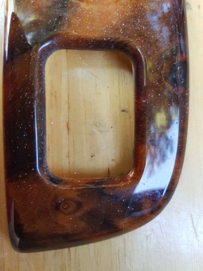

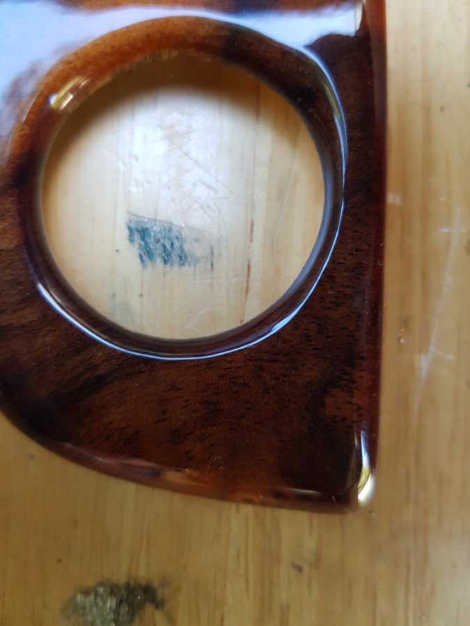

Here is what some of the veneers looked like when I first got them.

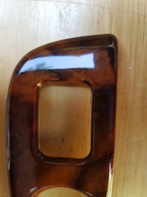

And then after I mopped them.

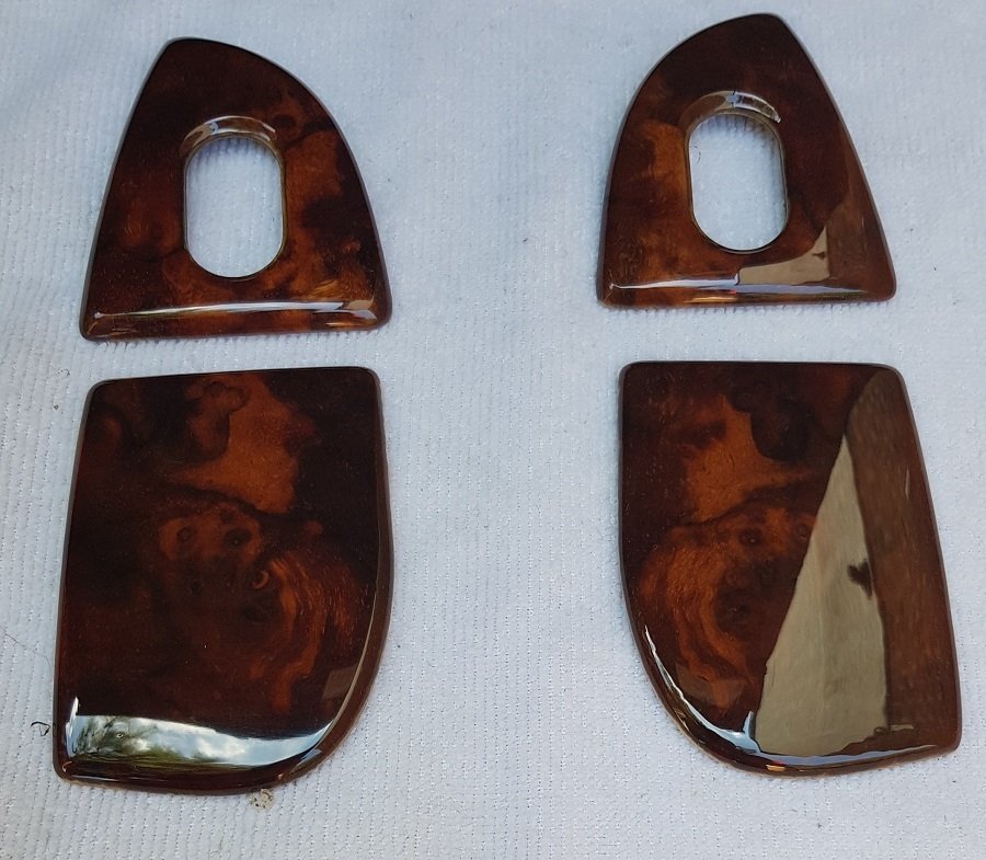

I was all prepared to sand down and re-lacquer but a bit of time spent on the polishing wheel was all it needed.

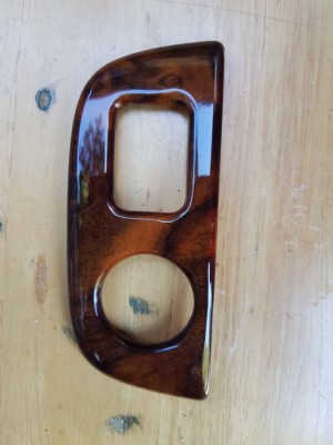

Here are the rear door window switches and ashtray veneers.
This is after I cleaned them up.
They are in the car now. :D
I'm very pleased with how all this is turning out :D .
