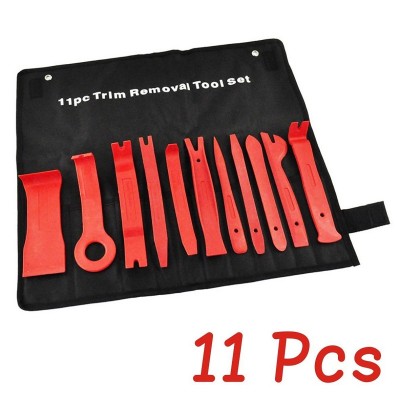

Luckily I have a good set of trim removers.

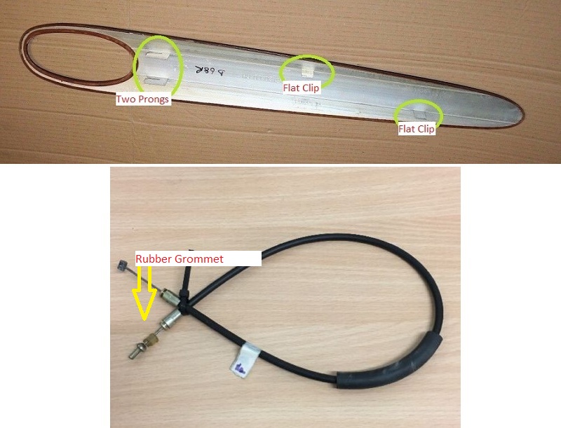

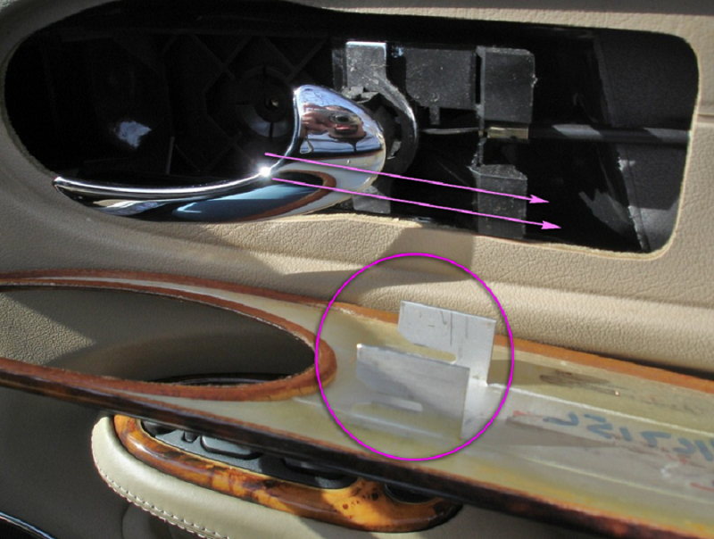

Useing a trim pry bar to pop out the two fasteners holding the veneer trim in the door,they are positioned behind the point of the arrows(don't force anything, :idea: if it seems stuck use two pry bars,top and bottom) and then SLIDE it to the RIGHT,there are two prongs that are behind the handle which is why you slide. Don't try to pull towards you or you could damage the prongs or even worse the veneer.
The Two Prongs

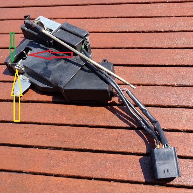

Door Latch
The yellow arrow is where the rubber grommet goes.
The red arrow is where the nipple goes.
The green arrow points to a little spring clip that pivots up to let the cable out and is very easy to come off(don't ask me how I know this :oops: ,only it's a bugger to retrieve,you have been warned)

Trim Remover Kit
This is the trim kit I have,about £10.00 off eBay.

Reverse Of Wood Trim & New Cable Grommet
Backside of wood veneer to show the two flat clips.
New cable with rubber grommet
