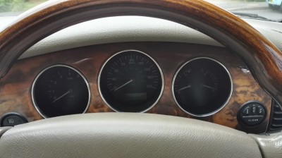

Anyway I was expecting loose rings to come in the post but they were still attached to the veneer :o .
Removed rings carefully and cleaned them up(ie removed old glue)and then set about glueing them on mine.
They are not flat and I found by turning them in the hole you can see when they have lined up and fit flush
Used the two part epoxy type glue and then once dry and stuck(next day)used thinners very carfully to remove glue that had found it's way onto the veneer and rings.
I think it makes all the difference to that part of the dash.

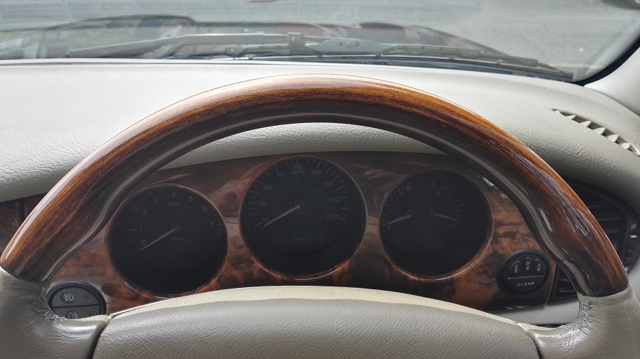

Before
After
