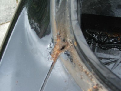

Being more serious now though.Another possible area is at the base of the rear screen, rear wing/cross panel joint.
If you get a torch,pop the boot panel, remove the inner wing carpet and petrol tank carpet - then look for the joint you'll see a big gob of bondo - factory fitted! I removed both sides on mine and ran a bead of Sikoflex in it's place.
This is the reason, along with the rear screen seal design holding water that we get rot at the lower corners of the screen. The water could be coming in via the joint at the base of the screen and running between the panels.

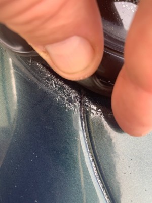

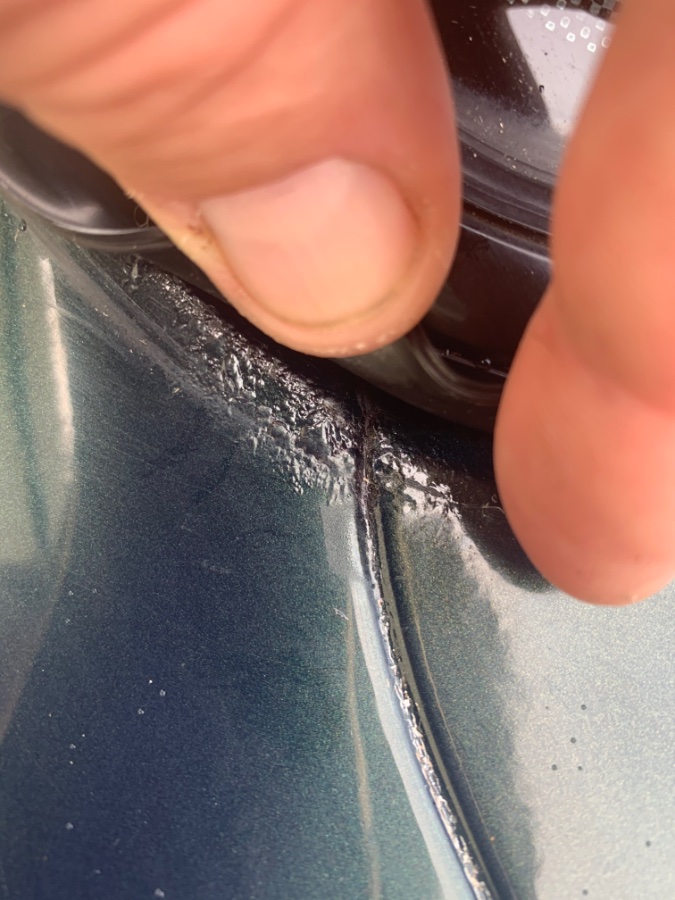

Yep a bad design, and notice the joint isn’t finished off or sealed properly.
Only a small amount on mine but going to “kurust” it then paint with isopon 182 zinc anti rust paint then eventually paint emerald green.
After that I’m going to ensure lots of black “screen seal “ goes in there and seals the end of that rubber. It’s weird how it traps water. I tried to upload but cannot seem to, just comes up “[img] “

I lifted up the rubber. In the groove below there was in fact water. Not loads just a bit. I soaked it all up, dried it off left it with a couple of wedges underneath the rubber in 80F heat. Then I kurusted and hammerited the lip and as much inside as possible. Then waited 24 hrs and sprayed waxoyl in the groove, finally sealed the rubber with screen seal. I think the rubber is rubbish as it doesn’t sit well. It always seems to lift in places even with screen seal.
