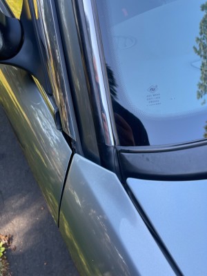

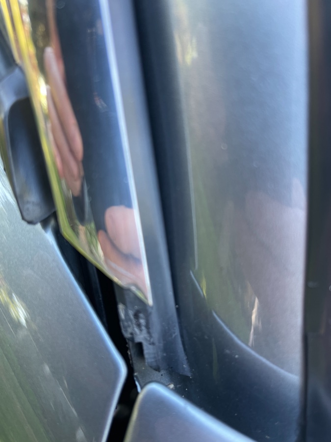

I also have the same problem. Given this is an old thread, has anyone made any progress on this before I start down the same rabbit hole? Almost everything else is looking good on my XJR apart from the small rubber 'stopper' at the end of this trim now being gone.

Hi folks, obviously an inherent fault / issue and one that Jaguar are unlikely to do anything about. There are now quite a number of folks using 3D printing to replicate older plastic part replacement, but appreciate that you don't yet have something that the whizz kids can scan to get the basic shape. I visited the Auto Sport show in 2024 and was amazed by the number of offering's for 3D printing.
It might be a long shot, but assuming that you can remove the offending / failed stopper from the lower end of the trim, keeping it relatively intact, might it be possible to carve something in wood or soft plastics to replicate the finished whole piece and then use that to ask for a 3D printed replacement in an appropriate material?
Going back to "making it out of wood" might be the way to go!

Thanks Jim. Sounds like 3D printing could be the way to go. I don't have an example of what's needed, as they were removed by the garage that did some paintwork on my car and were never put back. I'll keep an eye out for something that could be used as a 'model' or see if there's a way of crafting something suitable that could be replicated in a suitable material.
