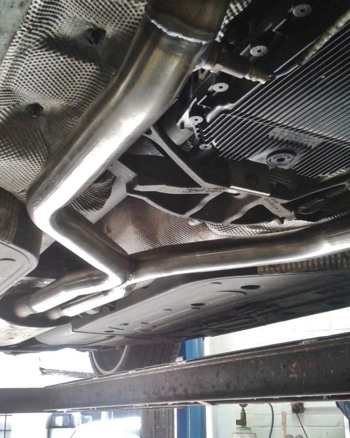

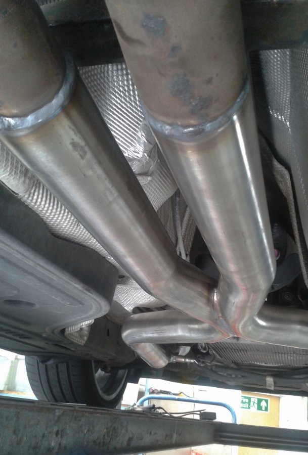

I removed my 350R centre box completely. With it went an H-pipe balance pipe between OS and NS exhaust downpipes within the OE centre box.
My new set up dispensed with the centre box completely. In the space, a free flow X-pipe was substituted to help improve gas flow. This was hand built by Longlife Exhausts in Carshalton in Surrey. This modification was done at the same time as I had sports cats fitted. This combined with an ecu re-flash and ported and polished inlet system together with clearing an obstructive ridge under the throttle body. In addition, the throttle body elbow below the throttle was again opened out together with gas flowing the elbow and the supercharger inlet and outlets.
Noise from the exhaust increased just a little without being the noise headache that a modified S-type R exhaust caused on my 4 litre S-type.
Images of my 350R exhaust mod are here. Mike K
