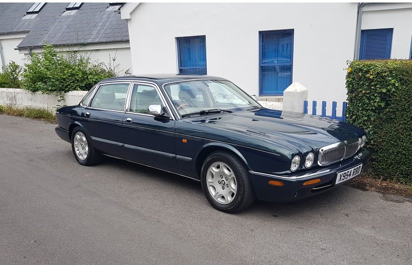

Had a drive over to Dawlish to visit my mother in law last Friday,lovely and cool.
In Dawlish
