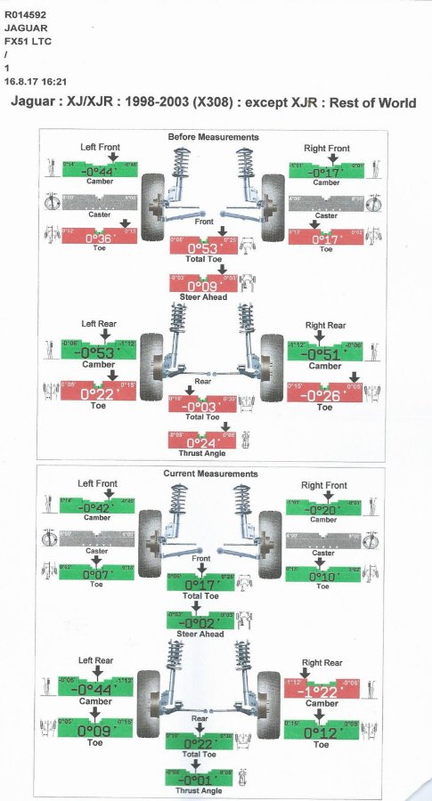

Forgot to update: Came back from Thame and had a four wheel laser balance done in Beaconsfield. Very good place for anyone local -- Broadway Autocentre fitted with Hunter equipment and a decent mechanic who took an interest in what he was doing. A few high end other makes were in there too while I was in the queue.
He found he couldn't turn the adjusting nuts, they were far too tight. Even WD40 wouldn't do it nor an extended wrench, nor an air wrench. So he had to resort to the torch, warning me of the consequences if thread stripped.
They didn't. He said someone's been under there and over tightened "everything".
Here's the printout: Apart from OSR that he reports needing a shim as there's no more adjustment to bring fully back into the "Green", it now tracks. Straight ahead is solid, there's no camber drift, and the steering wheel's at straight ahead too.
But the soft "Whrrrr" is intermittant. Seems to be noticeable when cold and driving off, only to go after a few miles. Weird or wot?
