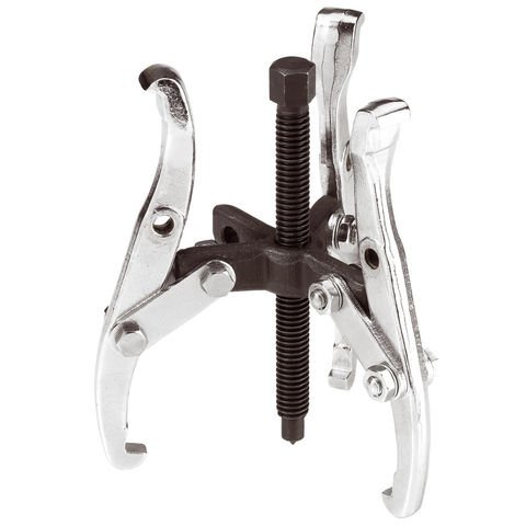

No special tools needed but you do need a hub puller,this is the type I used.

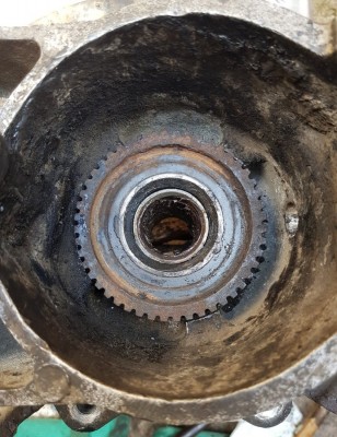

I did this by using a socket to push the hub through from the back of the carrier,the ABS rotor
is just a push fit and comes off once the hub is removed.

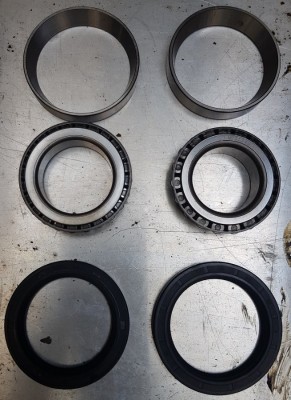

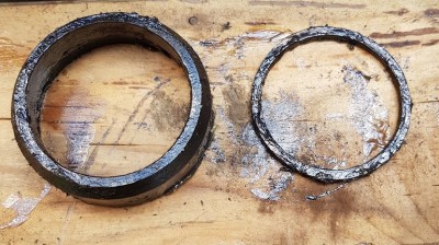

Then it's just a case of removing the old bearings and putting the new ones in.
Easier if you have access to a press but I did mine supported on wooden blocks using drifts and a heavy hammer.

It all worked out well and managed to drift the new bearings in without any problems.
Followed by the new oil seals.

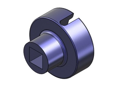

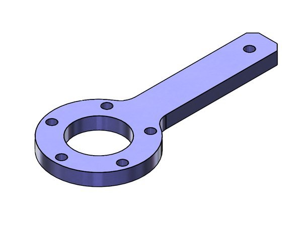

The tool you refer to is meant to help stop the hub from turning when you loosen or tighten the hub nut.
Here's the link:
https://jlrequipment.service-solutions. ... KU=204-195 I took the center cap off the wheel,put the wheel back on the car,lowered the car and undid the hub nut.
Did the same to tighten the hub nut.
Your garage should have a generic tool to do that job.
