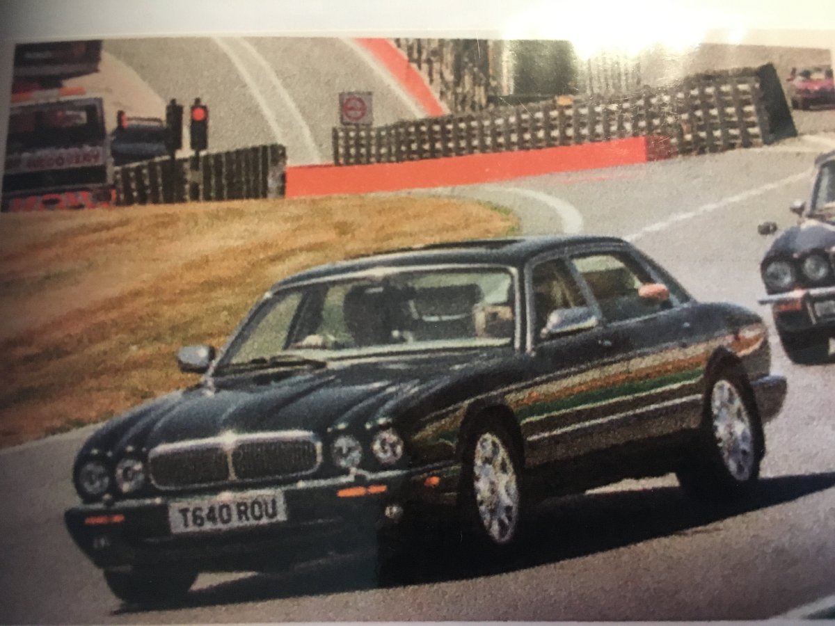

Hello all, I have recently restored a 1999 Daimler Super V8, which is in the classifieds on JEC (brands Hatch anniversary pic) and took it out for a run as it has been in the garage for 3 months after coming straight out of the paint shop, I noticed a couple errors come up, ABS, Traction control, and after consulting with the garage that did most of the restoration, I was advised to give it a run, about 10 miles out I noticed it wasn't changing up, I popped over to 2 and 3 no change, pulled over, restarted and all was good, another mile it did it again, stuck in first or second, (I think its the ZF "Merc" box) so this happens all the way back home, at one point we pulled over and there was no throttle and it wouldn't allow me to knock it out of Park, restart and it was fine,
