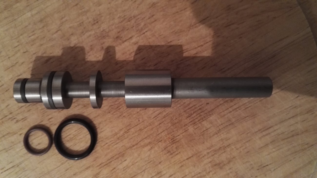

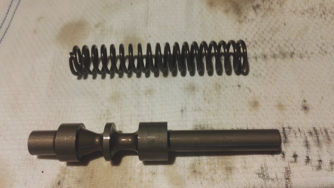

Also it is worth thinking about relacing the pressure regulator within the lower valve body with the TransGo replacment.
The replacement regulator reduces the risk of the dreaded A-Drum failure.

I did mine and it drives even smoother than it did before(and I thought it was preety good before)

Hi AJP,Hi Doug,
Have read abot it here:
https://www.jaguarforums.com/forum/xk8- ... de-179012/
I did mine and it drives even smoother than it did before(and I thought it was preety good before)![]()
Also make sure you use the correct oil and follow the correct refill method(Very Important).
Good luck.
Take care.
Andy![]()

This is the part that I replaced: I purchased mine from the U.S.A. link provided:

None of those,they look like solenoids.
https://www.ebay.co.uk/sch/i.html?_from ... *&_sacat=0

Hi Doug,
I replaced mine with the gearbox in the car and using axle stands.
Once the filter is removed you can see the lower valve body.
Once removed you can take it to your bench to replace the valve.
If you read this thread from the American Jag Forum it explains every thing you need to do.
Also gives the instructions in a PDF that come with the new valve.
Here's the link again:
If your at all nervous about doing it then don't.But it is really easy to do.
Also I work on my own with no help(I prefer it that way).
Yes I followed the instructions and put the new valve in the freezer,went in the valve body a treat.(The cold shrinks metal)
