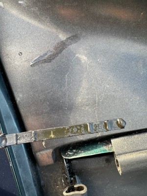

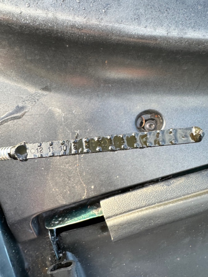

Re: Checking the gearbox fluid level - XJR
I checked mine at full operational temperature after about 15 miles.
I did this because I was in city traffic jam for 30 mins and I noticed reluctance to come out of first for age’s afterwards after getting to the outskirts of the city. Then I noticed warning light on dash “engine coolant level low”.
As I had already picked up my daughter and her boyfriend for dinner I pressed on as I was late.
The coolant warning went on and off… after reaching my destination I left her and then checked the water level.. didn’t seem that low so I topped it up with a pint of mineral water from the restaurant.
No more warning light.
This morning I got the engine and box up to temperature and used the dipstick- she was registering at just below the max scale of the 80 degree.
Oil looked fine.
I’m thinking the oil got really hot and stressed the electrical connector again… it happened in summer’21 so may well be soft.
Does anyone have a different opinion?
I’m tempted to just try and get a new seal for it and ask my mechanic to fit it..
