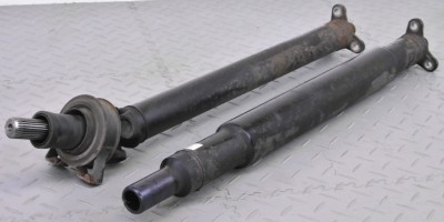

Still got to sort out that very minor whine that's been suggested as a "Quill Shaft" whatever that might be. It transmits itself to all parts of the car, but can't be heard from outside. And virtually disappears with a window open, or at above about 50mph. Weird. In all my years of driving scrot cars, never had a fault like that before... Will find out more on Monday
Had the Exec (Ludlow) into a transmission specialist in SE London (the Sport's super quiet) who've diagnosed the
carrier bearing. And yes, there's no spares nor is it a change out (unlike BMWs) item :evil:
:idea: They didn't charge for test driving, checking the wheel bearings on their lift, and doing their diagnosis. So
am recommending <drum roll> Foxberry Garage (inc. Helical Gearboxes) in Brockley SE4 Paul on 0208 691 5953
So the whole shaft (NND5800EC) has to be changed at a cost of £944 new inc VAT from Barratts (one ex-stock)
There's four possibles on eBay at around the £30 to £45 mark but what with £150 install (silencer needs to drop down) it's a gamble whether any one of these s/h supplied would be quieter instead -- what with the Alsatian's pee on them too :D
Anyway, just wondering if there's any alternative? Seems strange construct to me that this wear item can't be serviced -- but I'm not a mechanic. Any one better in the know please reply :arrow:
XJ8 SWB prop shaft showing "quill" and Carrier Bearing unit

Went to collect yesterday and boy, what a difference :!: Ludlow's transmission (and the rest of the car) is now sooo quiet :P Well worth the £160 notes inclusive. (mangy alsation on a rope wasn't there)
There's interesting opinions out there :roll:
Got shown the old carrier bearing who's rubber had gone so soft that you could move the two shafts around by as much as 30º up and down. He said you should'nt be able to move it, or hardly at all.
All the bearings and track rod ends had been "nipped" up by previous owner -- needing blow torch / WD40 to loosen to correct the tracking;
Bearings were checked each wheel and "un-nipped" and then tightened to correct torque ("You've definately got a bearing gone, sir!")
And the best was: "It's your tyres, sir! Those Nexans are known for transmitting road noise. We can change them for Cinturato P5 *&*(&*% supercalafragalistic expidalidocious all weather asymetric bla bla". :lol:
Thanks again to the boyz in Brockley who correctly diagnosed. And to Kevin for doing the job with a fair price.
