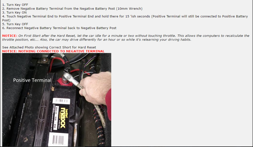

Regarding the column switch issue try a hard reset.
Which can sort many module issues like the one you are experiencing.
Make sure you have your radio code before you disconnect the battery
Here's some info on the hard reset if you have not done it before: You can disconnect both if you feel more comfortable, but its not necessary, it just takes more time. The reason I and others say disconnect the negative cable is for two reasons.
1) it is usually the closest and easiest to access.
2) there is usually little or nothing else attached to it.
The reason this works on the system is that they still have a complete circuit on the car so you are giving their positive terminal a path to ground to discharge them. And since the ignition provides a mechanical link to circuits that are isolated. You can/should also switch the key to the on position while the battery is unhooked and hard reboot again. Then shut off the key and go back and reconnect the battery.....and no a hard reboot will not clear codes on ODBII. While it MIGHT, turn off a check engine light(depending on WHAT, the stored codes are) they DO NOT go away.
Let us know how you get on.
Good luck and take care.
