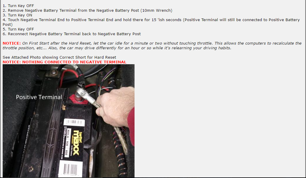

Regarding the unlock/lock button on the dash not working I would try a hard re-set.
Make sure you have the radio code though before you start.
If you do not know about the hard re-set this is where we take off the negative battery cable and hold it against the positive terminal for about 15-30 seconds.I always turn the ignition key to pos II while I am doing this and then turn it back to the off pos before re-connecting the battery.
If you prefer,take off both cables and hold them together.
Follow the instructions on the attatchment and you can't go wrong. Hope you get it sorted.
Take care.

Cheers Andy will give re set a go
