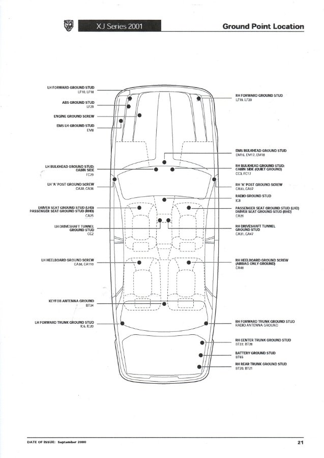

Have you checked the earth? The earth posts are a known weak point
Re: Indicator - 2002 XJ8 SE
Hello Case and welcome to the forum.

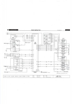

I don't think there is a fuse for the indicators as they are powered by the Body Processor Module (BPM).
Check the ground points as David has suggested,here is an extract from the XJ 2001 electrical guide showing the ground points. Here is the wiring diagram for the front exterior lights (XJ 2001) If you would like the whole Electrical Guide XJ 2001 in PDF just PM me your email address and I will gladly email you a copy.
