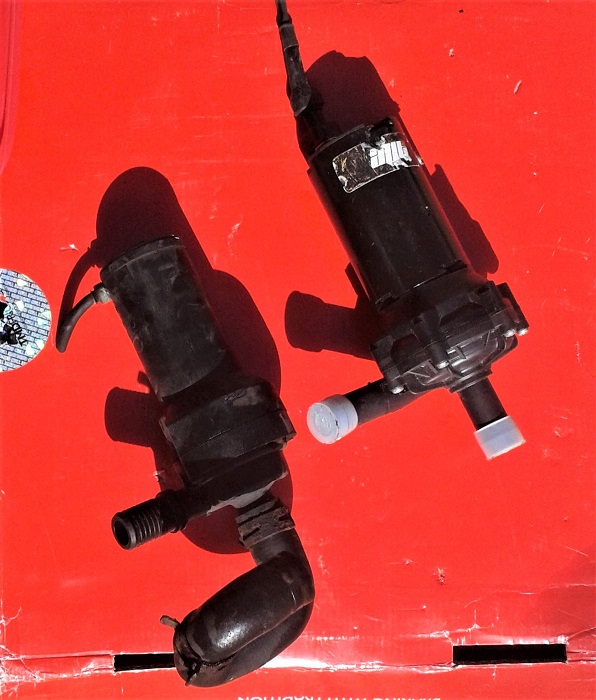

As you have an XJR, Bruce, the humming motor you are hearing is probably the supercharger intercooler circulation pump. It operates all the time when the ignition is switched on. The pump is located down low under the off side main beam headlight and connects to the lower left hand water inlet pipe on the intercooler radiator. One of the front pipes from the intercooler bricks take the hot heat exchanged water down to the pump. The reliable life span of this small and hard worked little Hella pump is about 130k miles. If it eventually fails, replace with a AVT Bosch metal high flow pump for about one third of the price of a standard Hella unit. Buy via ebay or Amazon for about £135......About £470 for the standard wimpy Hella pump!
I made reference to this pump in Part 2 of my methanol/water conversion article in the recent July 2017 No 7 magazine. The pump makes a big diffference to the way an XJR/XKR/XFR performs particuarly in hot weather. It helps lower inlet air temperatures after the inlet air has been through the supercharger. Anything that can be done to lower post charger air temps to lower levels is to be grasped with both hands. As you can hear that pump running, it is a reassurance that the intercooler circuit is having its coolant circulated. If the sound of the pump stops, this will be immediately felt as reduced power output and is likely to be accompanied by very hot intercooler bricks on top of the engine. If you can`t keep your hand on an intercooler brick when the engine is running, you should assume the little Hella pump has had enough of working in a hot place. Bring out the AVT Bosch pump which has big enough muscles to satisfy the drag racing boys. Highly recommended.
In this image, the larger high flow Bosch pump is on the right. This pump fits most Jaguar R spec`d cars including X300/X308/X350/STR/XKR/XFR as is suitable for both 4.0 and 4.2 litre cars.
Sorry. Gone off thread slightly!
