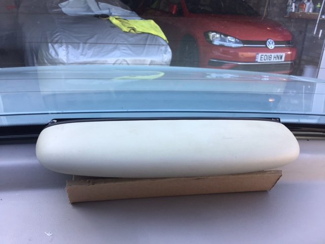

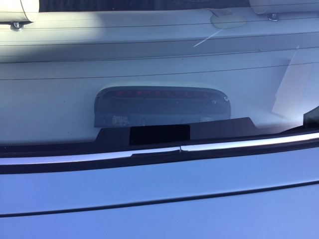

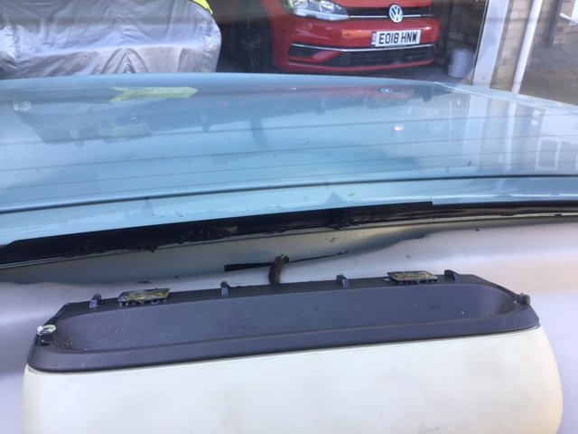

Assistance needed please. I have a problem with my rear Lamp-high Mo (that's how it's described) Jaguar Part No: LNC5000AFAGD.
It has come adrift from the rear window and I initially tried superglue to stick it back to the window. Fell off after a few months. Then tried araldite but again failed to stick it on for any period of time. Can anyone suggest anything else. Or is it likely that something is missing/broken off the light fitting - see photo's.

Hi Andy, thanks for the link. In your comment you mention that new brake lights do not come with brackets. They don’t, but on inspection of my existing brake light, there are no brackets either on the window or the unit itself. Now thinking of it, when I had the car completely resprayed, the rear window was taken out. I now wonder whether the brackets were removed and not put back. I have tried to find pictures of the rear brake light bracket without success. It doesn’t look as if I can purchase then separately. I am now considering purchasing a universal rear high level LED brake light. There’s plenty on eBay which stick to the rear window.
Re: Lamp-high Mo
Hi Doug,
In your first post I can see the little brackets in the middle photo of your lamp.
If you look from below looking up at the lamp you will see a little prong which when pulled should release the bracket,one at each end.
