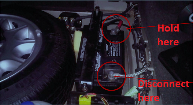

First thing I'd try is a 'hard reset'(solves many electrical problems).
Disconnect the battery at the negative terminal and hold it to the positive terminal for about 30 seconds - REMEMBER TO HAVE YOUR RADIO CODE. This process puts the car's programming back to original and might bring your door actuator back on-line.

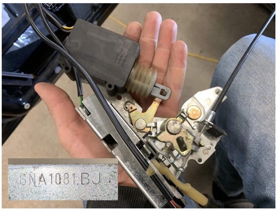

You will need to remove the door card to get to the actuator but before you do anything give everything a clean and a spray with some WD40 or similar lubricant.
I had the rear passenger door on mine not locking at all,a good clean of the moving parts got it all back working and has been ok since.
The mechanism your looking for is this: Hope that helps a bit and good luck.
