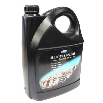

Coming along incredibly late to this party, I have a 2001 Daimler Super V8 & a 2005 Jaguar Super V8. Do they both use the same coolant specification? Daimler plate says Long Life ref WSS-M97B44-D coloured orange. Not sure what spec the Jaguar is.
Re: Engine coolant
Posted: Tue Mar 01, 2022 12:54 pm
by Andy P
Hi David,
Yes,they both use the same spec coolant ie WSS-M97B44-D .
I use Genuine Ford Super Plus Premium Longlife Coolant.
WSS-M97B44-D
Which is exactly the same spec as WSS-M97B44-D .
Hope that helps a bit.
Take care.
Andy. :D
Re: Engine coolant
Posted: Tue Mar 01, 2022 4:28 pm
by Davidqhog
Thanks, Andy. I'll get some of the Ford goop! :)
