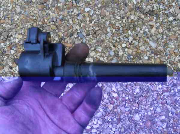

Re: Engine Miss Fire
Yip, that`s what happens.
Just done one on my S-type which was spluttering away like crazy on hills. Changed a coil on No 1 OS bank and instant result.
