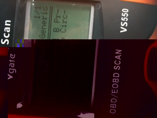

Re: Restricted performance
Managed to get a code!
pic attached..............
