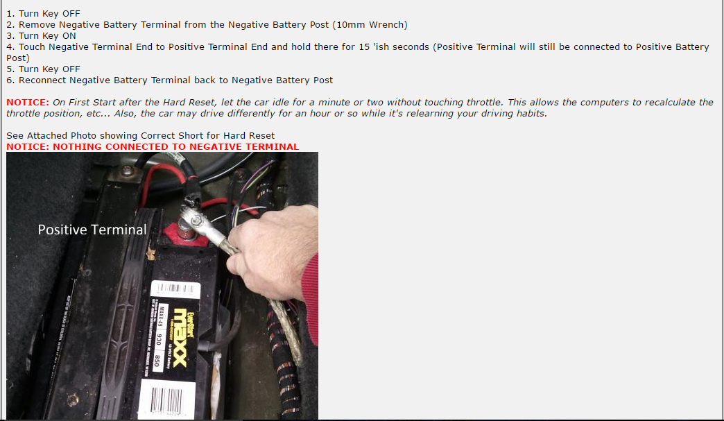

Hi Stuart and welcome to the JEC Forums.
Sorry to hear about your problem after such a short time.
First thing I'd do would be a hard reset.
That means take the negative cable off the battery and hold it on to the positive terminal for about 30 sec.
Have an accomplice turn the ignition key to aux 2,this should drain the cars modules.
Then re-connect battery and see if the car has gone back to normal.
Good luck.Let us know how you get on.

Re: Fail safe mode after hot start
No,the ECU is located under the plastic panel next to the coolant reservoir under the bonnet on the passenger side.
I take it your in the UK,if your not then the driver side.
Here's a couple of photo's of the hard re-set. If you would like a workshop here's a link to mine:
Thanks Andy, much appreciated! She’s running fine now, luckily I know my local garage well and was diagnosed with a poorly performing TPS, reading just 7% on the code reader. However I suggested the hard reset as you described and despite him saying in jest that it normally doesn’t work, it solved the issue...
The lesson learned from that, is never to rev hard (or maybe never at all) when in park position, I suspect the module senses something not right and protects the gearbox/engine accordingly. So all good!!
Hi Stuart,
Glad you got it sorted easily.
The hard re-set is always a good place to start especially with sensor issues.
It's easy to do as well and if it does not work then we have to look a bit deeper using the code reader.

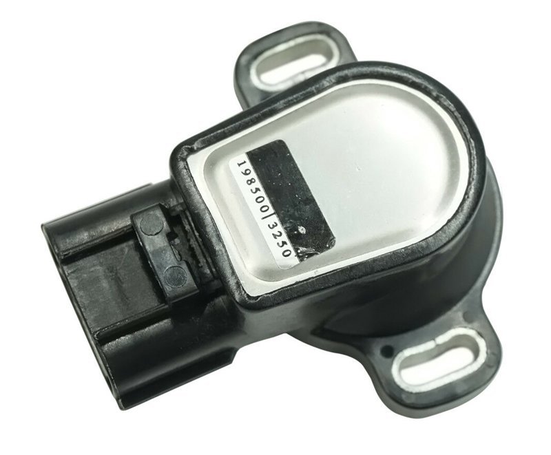

Re: Fail safe mode (suspect TPS)
I did the hard reset after an embarrassing limp home.however it didn’t seem to work properly like last time. Instead the engine light remained on amber. Did seem to drive ok though but I only went a few hundred yards.
As she’s still under warranty I’m going to book her in for a swap out of the TPS. That’s what the garage code reader came up with. Whilst there I’ll inform about the pipes..
soooooo annoying, only done 3 trips in her and it s like I’m not enjoying it.
I’ll see what happens tomorrow morning, garage is really busy but will try to fit her in
Would anyone know the exact part number for the TPS? (XJR V8 4.0 SC, 2001) and I need the gasket too, right?
Not sure how to post a pic on here yet I tried “img “ but it never points to any pics on my device.
Cheers, Stuart

Hi Stuart.
Sorry to hear your still having problems my friend.
The TPS unit is not sold separately by Jaguar you have to buy the whole throttle body
The OEM Part No is 198500 3250 But if it is the TPS that is faulty then DCR AutoParts has new ones listed.Not sure how much though.
Here's the link:
https://www.xk8-parts.com/2020/04/air-a ... lery-page/
I would get the garage to check for any codes before doing anything but they should do that anyway.

Re: Fail safe mode intermittently
hi Andy / all, that's really appreciated, thanks!
i fired her up fist thing and well, no warnings/fault codes. So --
i went down to my local garage who agreed to do another system diagnostic check at very short notice. I kept her running whilst he did it, and came up "P1222 Pedal demand sensor B circuit low input"
so he said it would definately need a new TPS - i said ok i will do a search myself rather than rely on euro-car-parts or whatever...
Being new i started at the front of the current JEC magazine and looked up suppliers one by one for this part, none could find it, apart from two, who kindly stated they only do the entire throttle body, which is absolutely absurd for something which costs diddly-squat to produce.
-- so after 2 hours of web searching and 'phone calls I tried ebay, MRA in Glasgow had one and i called him to check. (https://www.ebay.co.uk/itm/353100729974) it seems alot cheaper than DCR too. The OEM matches the one on mine too 198500 3250. so i did "buy it now"..just over 36 quid free delivery.
Would I need a gasket separately? if so, i am tempted to ask a part number, but if Jaguar did not sell this separately not sure?
i also could not find anything on the halfords website for the pipes J44EAG mentioned, "small 3mm OD rubber pipes, one coming off the SC pressure stub pipe and also the one below the throttle body. Both link to the bypass actuator. These two pipes rot and split with age"
it would be good for a link for those too? i don't want to get just any old 1/8" pipe.
although she's under warranty, I may contemplate doing the swap-out myself, i can see it would need the air flow/filter ram pipe taking off to get to it, maybe simple job? is that all i need to do, in order to then just well, presume, unscrew / unplug the old TPS and replace it?
