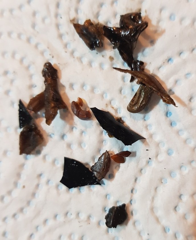

I gave my XJ8 a little service last week and I thought this year I will drop the sump pan during the oil change.
Mainly to clean the oil pick up pipe which has a mesh type screen in it to stop any debris returning up into the engine.
This is what I found,very unusual I think.
Swarf
Remains of some instant gasket
Two pieces of swarf and a few bits of what I think is instant gasket(soft like rubber).
So I'm guessing someone has had to do some work on the engine in the past but not sure what but at least I know the screen has done it's job in not allowing it back up into the engine.I suppose it will remain a mystery but at least it's all out now. :)
