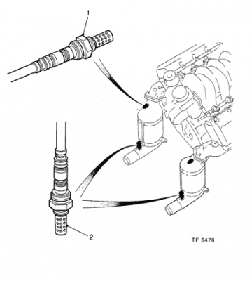

P1647 relates to the passenger side top O2 sensor.
DTC P1647
As you can see from the list of possible causes, sensor failure is listed last.
Might be worth checking the electrical connections if you have been working in that area.
You have the correct Part No LNE1684BB but you only need one if your only replacing one.
No1 LNE1684BB No2 LNE1682BC

Thanks Andy, just to clarify, its just one oxygen sensor needed as show in the example?
Andy P
Posts:960
Re: P1647
Postby Andy P » Thu Feb 07, 2019 10:05 am
Yes that's right Doug,the drivers side O2 sensor will come up with a different code if that one fails, P1646 I think.
Good luck
Andy :D

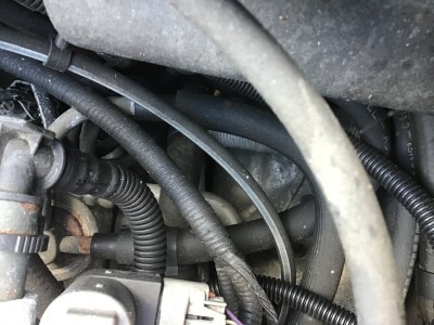

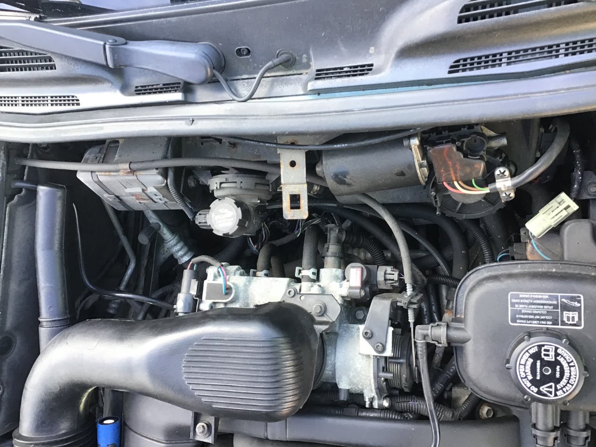

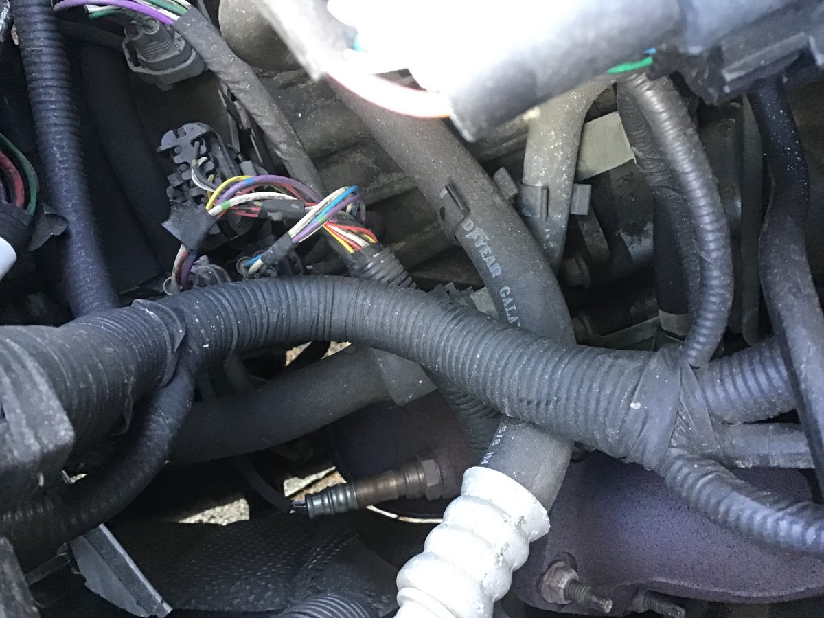

Postby DougX » Mon Feb 11, 2019 4:02 pm
Hi Andy,
Looked in the engine bay and can see the drivers side oxygen sensor quite clearly (bottom left hand corner of picture). However, can't see the passenger side sensor.
This is the drivers side top sensor.
Looking down from the top of the engine bay you will see what I can see.
Getting in closer you will see (hopefully) a heat shield which is above the passenger side exhaust pipe.
Do you know if the sensor is behind this heat shield as it seems a bugger of a job to get to it with all the pipes around it, or does one get to the oxygen sensor from under the car?
Further note: I can't see any cabling for the oxygen sensor in this area.
Andy P
Posts:960
Re: P1647
Postby Andy P » Mon Feb 11, 2019 4:49 pm
Hi Doug,hope all is well.
Yes the O2 sensor on the passenger side is underneath the heat shield which makes it a bit awkward.
Here's a link to a good write up of the procedure with some good photo's from jaguarforums.com:
Second post in the thread cover's the passenger side.
https://www.jaguarforums.com/forum/xj-x ... nt-195018/
