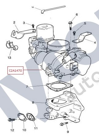

For the butterfly use Servisol and not WD40 which has an oil in it. Clean all round both sides of the butterfly edges
and with a tooth brush the whole area of chamber. Watch as pressing accelerator does move the butterfly in a smooth way. Check both connectors are firmly in with a squirt of Servisol to each plug / socket. Check all hoses are not frayed underneath their hose clips. These clips need to be tight. Replace with new if in doubt. Did you use a new TB gasket?
Let us know how you get on?

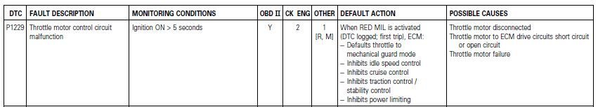

The P1229 code on the 97-03 XJ8 relates to:
Throttle motor control circuit malfunction. But it wouldn't hurt to clean the butterfly anyway.
Also clean the plug connections on the throttle body,there are 2, use contact cleaner and then reconnect.
If still no better it's time to look at the ECM/ECU,either take it to a specialist and have it checked out,
if your savvy with electronics do the pin point tests yourself or get a replacement ECM/ECU and just swap them over(no reprogramming required).It's situated under the plastic cover,the one with the tool kit cut out in.

Did you use a fresh gasket? (7) (second request) I also have a good .pdf with pix I can send anyone interested that's for cleaning the TB and MAF and part & full load breather orifices (courtesy Mr Texas Dan via Max Performance Cars website)
