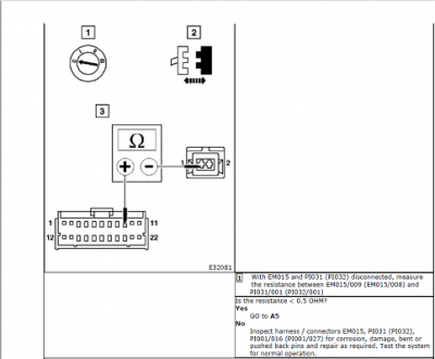

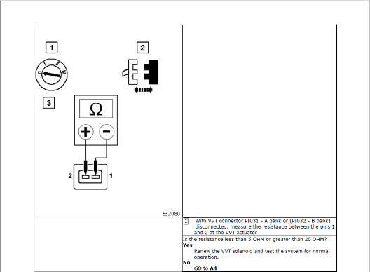

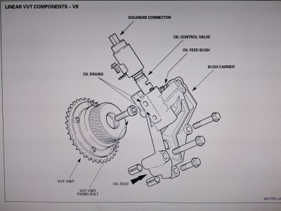

Hello Again,
I carried out a flush and oil/filter change and it looks as clean as a whistle in there. It has improved the tapping in that it has reduced the volume and the time it goes on for. Does anyone know why it goes on for about 10mins until the engine warms up then disappears? One would have thought that if it was due to contamination that the symptom (tapping) would be there all the time?. Also anyone ever tested the VVT solenoids in situ? Assume you can check for continuity? Rgds. Charlie.
Re: Engine tapping when cold 4.0L
Hi Charlie,
Here are a couple of pages taken from the X308 Workshop Manual about testing the VVT Solenoids: It's a shame PDF documents are not permitted to be added to the post:( .
