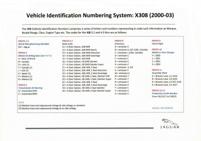

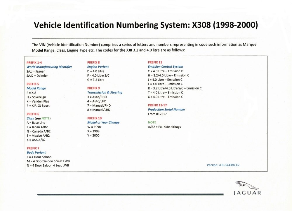

Re: Nikasil Liners. Hard starting.
Hi Bruce,
Here's some more info on Vin Number's and Engine Number's.
Firstly, the X308 engine number gives easy dating information. A typical number will be 010615 02:10. This indicates an engine build date of June 15th 2001 at 2:10
01=year
06=month
15=day
02=hour
10=minute
Secondly, there are two locations where the engine number was stamped, depending on the manufacture date. 1997 thru sometime in 1999 the engine number was stamped on the block casting next to the thermostat housing. Sometime during/after 1999 it was moved to a location on the block under the left-hand exhaust manifold.
The location under the left-hand exhaust manifold is easily visible if you remove the front left-hand wheel and look through the wheel well.
The Vin number can be de-coded as follows. Hope that helps a bit.
Good luck.
Thanks Andy
Yes that helps a lot.
Regards Bruce
Regards Bruce
- RichardSEL
- Posts:845
Yes, very useful charts. Thanks from here too. So the "F" in the VIN does not mean ferrous.Thanks Andy yes that helps a lot. Regards Bruce
Must've been an old Jaguar wife's tale I've picked up -- mind you that's Coventry for you
