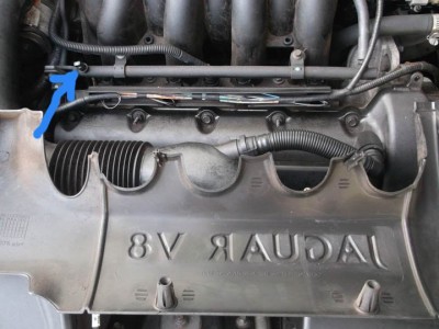

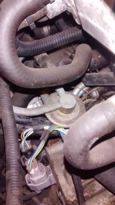

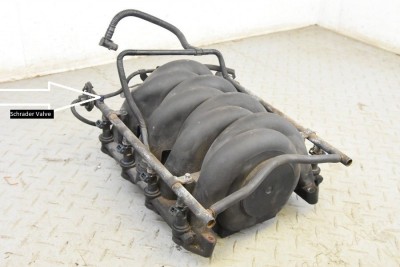

The fuel pressure regulator is at the rear of 'B' bank tucked down to the left hand side of throttle body.
The schrader valve is on the fuel rail.
Fuel Pressure Regulator
Schrader Valve
You should have 41 psi at the schrader valve at idle.

This could be suspect. I found the Schrader valve. Mine was under a blue screw off plastic cover. But doesn't look like the one in this pic (location's the same though)
With the IGN on, there's a dribble of fuel out of this valve when the centre pin is pressed. It smells like fuel alright. But it's only a dribble

That is a picture of the fuel pressure regulator. A Schrader valve is like a tyre valve and is on the fuel rail (left hand I think). Plug a fuel pressure gauge into that.
Hi David,thanks for correcting me,you are quite right that is the fuel pressure regulator not the Schrader Valve
as I had thought :oops: .

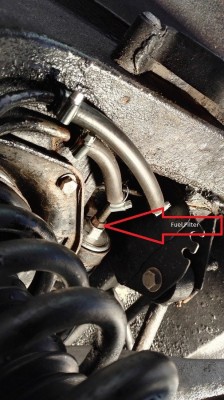

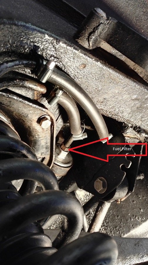

The fuel filter is located above the rear axle on the near side of the car,tricky to get your spanners up there.
Location of fuel filter
Which is why it gets left I suppose.
