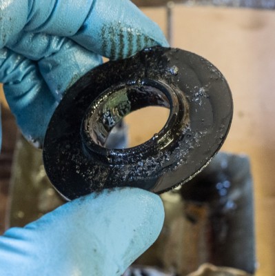

I do all my oil changes on all my cars myself. One of them is a 1986 Alfa Romeo Spider. I always run it on just mineral oil, which is in accordance with the original Alfa Spider recommendations. Half a year ago it had to go for its MOT. And as I did not have time, I asked them to change the oil and filter. They put fully synthetic oil in and a new filter. I opened up the filter after 500 miles
Look at some of this debris that had already collected:
