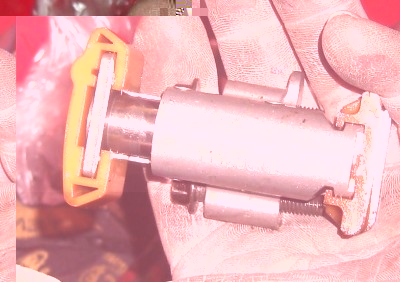

Here are mine at 44k miles. The example on the right is from another car. Bottom foot recovered from the sump. Note the cracks on centre and left examples.
You will find many postings on the 308, XK8 and S-type BBs relating to this subject. Replacement ali units are around £90 a pair. Labour of course at extra cost.
The only reliable units are the fourth generation items which appear bullet proof. Note how robust the ali unit is compared to the previous plastic versions.
It is not a question of if the tensioners will fail, it is when.....

I`d strongly suggest you have a competent Jaguar man examine your car and ensure that the ali tensioners as shown in the above images have been fitted. The brown plastic tensioners shown above were from my V8 S-type at only 44,000 miles. The cracks are clearly visible and would have failed had I left the units in place.
This problem is no respector of low mileage or even gentle driving. If plastic tensioners are found, they will need to be replaced. That done, the engine will achieve a high mileage.
