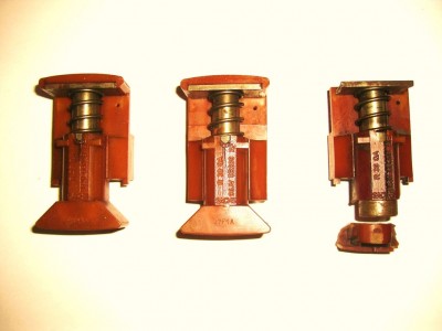

This is why the top secondary tensioners if made from plastic need changing. Note the cracks in the body of the unit (mine on a V8 at 44k miles) and also one tensioner off another car which has really come to grief. Slipper plates torn off and lower body smashed in. In such cases the chains will probably also need replacing as metal to metal contact does serious damage.
As I recall two ali new type (fitted as standard on the 4.2 V8) can cost only around £100 for a pair. A bit more if chains are needed.
Here is a shot of the new ali type which has proved very robust and long lifed in service. For years within the Club this issue was a never ending subject. Thankfully most V8 4 litre Jaguars will have had there tensioners replaced. However some may not be so fortunate and those cars will be living on borrowed time. The only sure way to tell if they have been replaced is to lift a cam cover and have a look inside. If a seller cannot prove the tensioners have been replaced, you will as previously suggested have a good lever to lower the purchase price of a potential car purchase.
This matter affects X308, S-type V8 and XK8 models....3.2 and 4.00 litre models but NOT the later 4.2 litre variants from around 52 plate onwards.
Any car which rattles from the front of the engine upon start up should immediately be switched off and definitely not be driven until a diagnostic visual investigation has been carried out. No ifs or buts on that...the engine is about to disintegrate!
