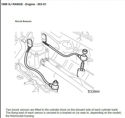

Here's a bit more info.
The Knock Sensors are easy to replace,they are on top of the engine,secured by one nut:
Knock Sensor Position
You can check a few things before proceeding with replacing them.Is water sitting in the valley beneath the intake manifold. If so it will short out the knock sensor. If you have water it could be a valley hose is leaking. Also, look for water staining around the sensor.
You can check them for broken or damaged wires. If none of that is present then the sensor has probably failed.
Before putting the new ones in use some WD40 and a paint brush to clean the mating surface on the engine for good contact.
Take care not drop the new Knock Sensors,they are very fragile.
Tighten the nut to finger tight and then torque to 20Nm or 14 lb/ft.
If you want a workshop manual let me know and I will send you one using WeTransfer.
Take care.
Andy :D
