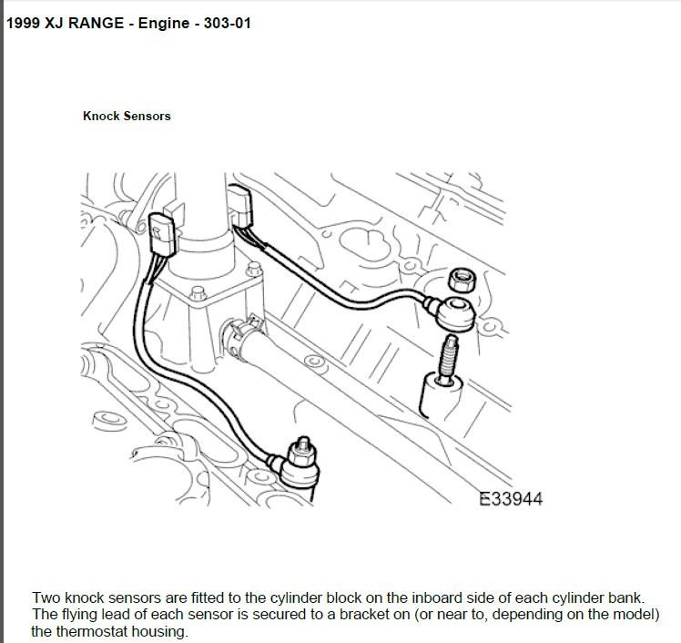

Here's a bit more info.
The Knock Sensors are easy to replace,they are on top of the engine,secured by one nut: You can check a few things before proceeding with replacing them.Is water sitting in the valley beneath the intake manifold. If so it will short out the knock sensor. If you have water it could be a valley hose is leaking. Also, look for water staining around the sensor.
You can check them for broken or damaged wires. If none of that is present then the sensor has probably failed.
Before putting the new ones in use some WD40 and a paint brush to clean the mating surface on the engine for good contact.
Take care not drop the new Knock Sensors,they are very fragile.
Tighten the nut to finger tight and then torque to 20Nm or 14 lb/ft.
If you want a workshop manual let me know and I will send you one using WeTransfer.
Take care.

thought id give you a update, upon further inspection, it appears that there is a small leak in the thermostatic housing and i think this may be responsible for the knock sensors fault, as the knock sensors look pretty new. So new plan of attack is, fit a upgraded metal thermostatic tower, replace some hoses as age etc, then see where we are. will keep you up to date

Hi Rob,
When I did mine I loosened the intake manifold bolts so it would lift up a little to enable me to get the rear two housing bolts out.
I replaced the original bolts with allen head bolts for the housing.
If you want to test your knock sensors they should read in the region of 200 ohms,if it reads considerably lower then it has failed.
Good Luck and take care.

Done it!!...sorted, tested the faulty sensor, it was reading 140 ohms, changed it and now all ok, the rear bolts were really fiddly but the crows foot was the way ahead for me...
