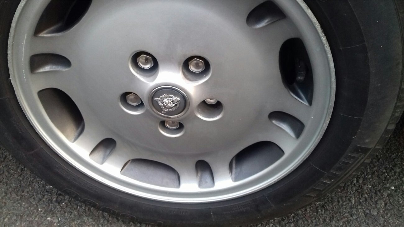

Did I see that you are something of an expert on wheel nuts? One of the wheel nuts on my car is shorter
and therefore more deeply recessed than the others, I think it is an odd one and should be replaced.

I think the 98 3.2 Sport came with Dimple wheels as standard but they might have been changed by a previous owner.
The wheel nuts should be all the same length and I think the Dimple wheel takes the long shaft wheel nut.
If you have different wheels here's the info for all wheels fitted to the X308 as standard.
