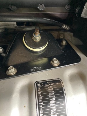

I've used a brand called Meley, the part comes as a whole (as in the black metal bits and the joints already assembled, see picture), so all you do is jack the car up, unbolt the old one and place the new one in, the whole process took less than 30 minutes for both sides. They were a lot cheaper than the original Jag ones and that's a job that can easily be done at home.
Hope this helps.
Hope this helps.

Flo-90,I think you might mean MEYLE.
I have heard good and bad reports on their products.
I have used their anti roll bar links with no issues.
If you have access to proper garage equipment you can just replace the bushing in the top mount,which is the same as the rear suspension top bushing
