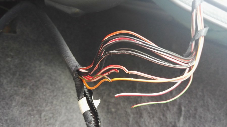

Your most likely cause will be in the area where the wiring enters the boot lid by the hinge on the drivers side.
There could be a broken wire within that area.
This was the state of mine when I had problems. If all looks good it could be the solenoid,so that will need checking.
You didn't say if the boot button worked or not,I take it it didn't which also points to the wiring being suspect.

Hi, Not sure if this will help but on my X type it was loss of earth to the boot. If your XJ has the loom coming out from the body to the corner of the boot lid then it is possible that the earth cable may have been broken. I could go on as to what to do but I`ll let you see if that is the problem. Let me know if I can be of any further help. Regards Rob.
