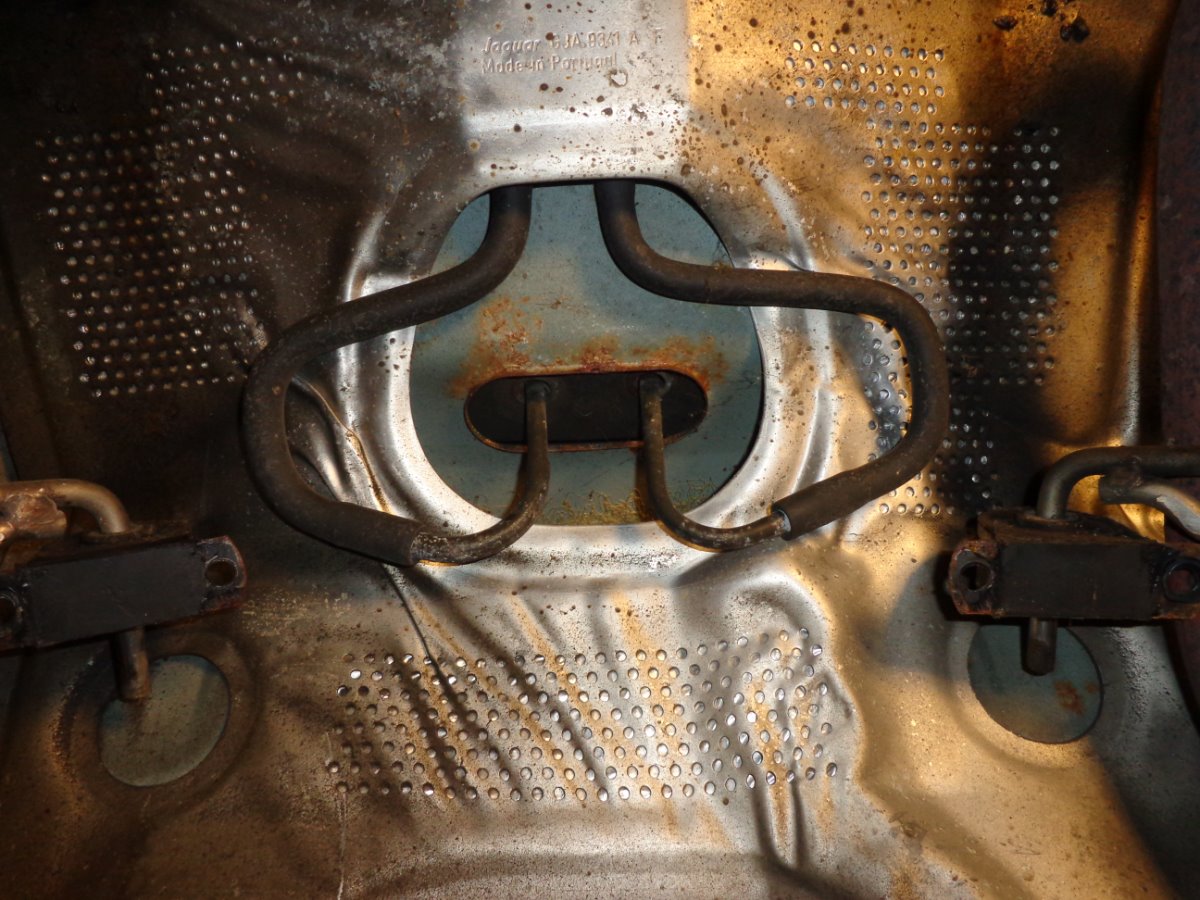

Gone for the hole in the boot technique - works on my 2005 XK8 convertible if you get the hole in the right place - top of 50mm hole right up where the vertical of the boot goes horizontal and the right edge of the hole just to the left of the stud which holds the power connector box (pity I got it slightly wrong first time .......). Only thing is you have to go through the bracket plate behind also. However this wide bracket plate looks like it horizontally stiffens non-structural things behind the rear wheels by connecting the boot to the rest of the floor pan through two light diagonal struts, so a hole is not going to affect it. Once you have the hole a wobble extension set up goes straight onto the filler plug. Large extension needed to get enough torque to loosen it. After this 1.7L of blackish fluid sucked out and refill done with a funnel and tube. Not quite finished yet as had a little fluid spill so need some more. Will fill hole with sealed plastic plug. Drilling holes in your car is perhaps not for everyone but my mind is at rest regarding the diff.

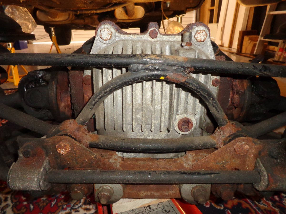

Luckily, fate intervened and the fuel pump failed, replacement being another impossible job as the fuel pipe unions to the tank are only being accessible with the differential removed. With such fortuitous luck now coming my way, this was the opportunity to carry out two impossible jobs.
I’ll not go into how I did it as I think it has been covered very well elsewhere. Since I had the rear of the car in pieces, I did at the same time wax all those places it is not normal to access, replace all the bushes on the rear suspension, had all the parts that came off shot blasted and Hammerite coated and replaced the fuel filter.
Not using the Jaguar very much it did not matter that it took me weeks to do and having a large heated garage I could work regardless of weather and light.
I consider both jobs total swines to do and all the access problems could have been designed out. Two first class examples of bean counter engineering.
I have attached a few photos which may help.
