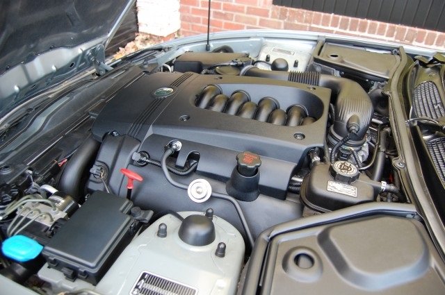

Hi DavidA,
I think the easiest way to check if you have CATS fitted is if you look in the engine bay there should be a cable coming from the top of the shock absorbers. Hope that helps and all goes well with acquiring the XK8.
