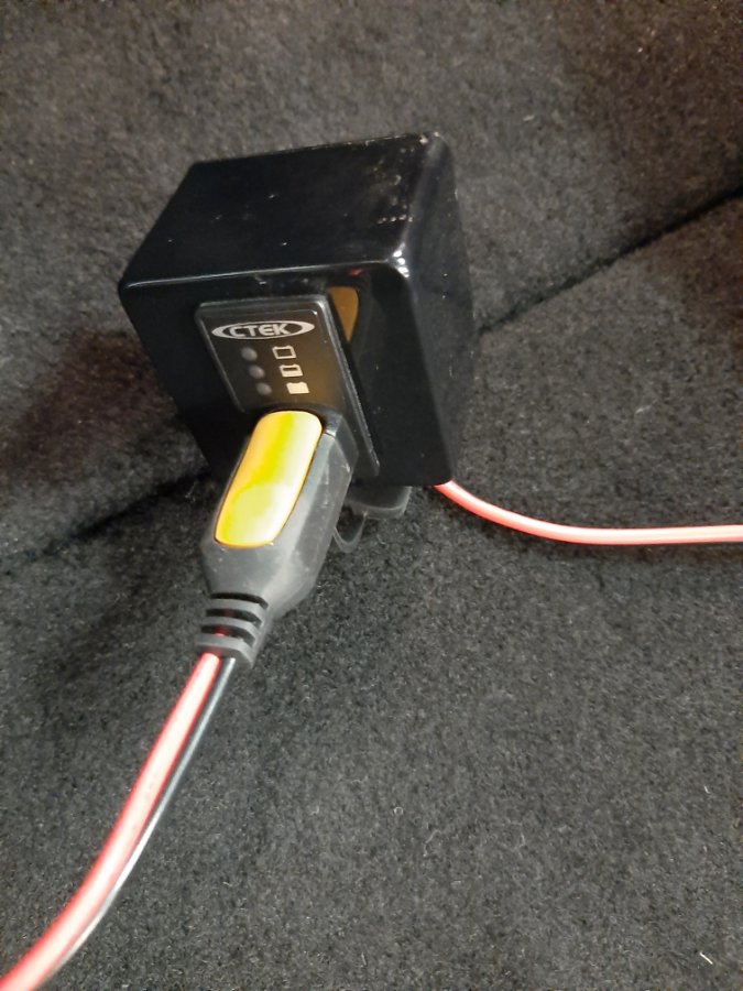

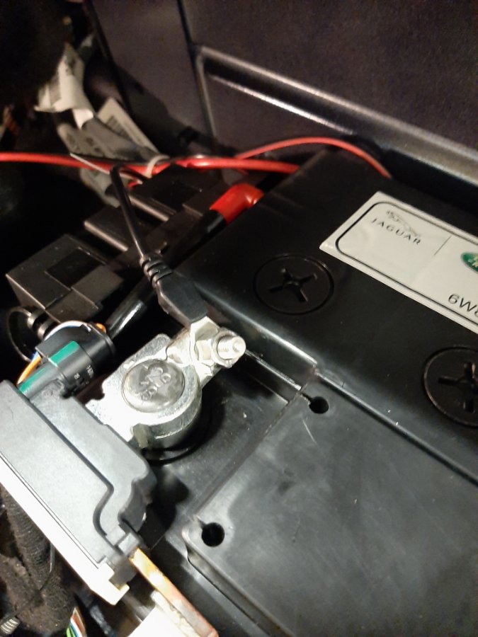

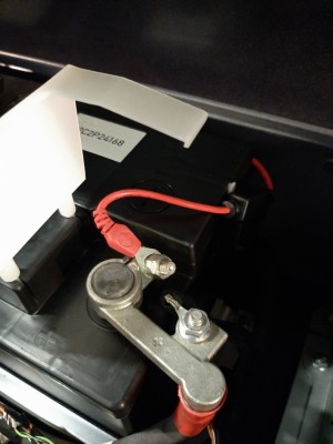

I have a CTEK connected directly to the battery terminals of my 2014 XK Signature, all works great with no explosions or other catastrophic events to date (although 2020 is not finished yet!). You do not have to disconnect the battery, just undo the nut without removing the post, slip over the eyelets for positive and negative, and replace the nuts one at a time. I use the CTEK indicator unit as shown in the photo which is permanently connected to the battery, I then connect the CTEK via an extension lead whenever the car is in the garage. When not in use, the indicator tucks behind the black elastic strap in the left hand side of the boot. I find that if I leave the car more than a week without the charger it throws all kinds of strange messages when I next start it up, 'Faulty Pedestrian System' seems to be a favorite, and I have no idea what that is. All you have to remember is to turn off and disconnect the CTEK before driving away......
