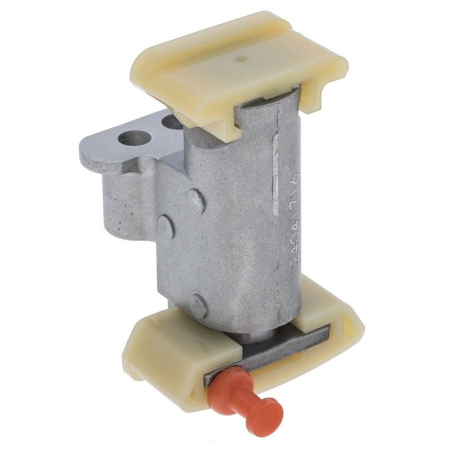

If you haven't already checked to see if you have the upgraded tensioners I would do so rather quickly.
From your video I see you have the upgraded thermostat housing so that's a good sign
If it hasn't been done,at 130000 miles it would be wise to replace the primary and secondary tensioners as well as the chains.
Easy to check,just remove the rocker cover's.
The upgraded tensioners will have an alloy body.
