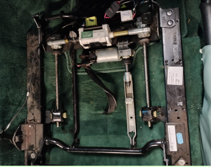

Well the base is out and on the bench i tried a couple of wires directly onto the motor but it was still really stuck so I then went about finding where the front two bolts were and marked up and drilled above them with a 20mm hole cutter with a really short pilot drill attached and carefully cut a hole to see if it was possible got to the torque screw but it wouldnt move so drilled that out tapping size as well whilst I was in a drilling mood. On the tunnel side again drilled with the hole saw and that screw came out quite easily.
The frame was really tight into the transmission tunnel and that is what was holding it there is quite a bit of movement on the frame to holes and it looks like it can become slewed.
I got the frame on the bench and piggy backed two wires with a fuse to the two pink wires going to the motor and after a few tries its back working again.
Next job is to try it into position without the seat to see that it works without sticking I will leave the two wire on as I can adjust the seat back and forth even if the module isnt working it will still move back and forth.
I will then take it out re attach the seat and wires and re fix hopefully will all be up and running in a day or two.
