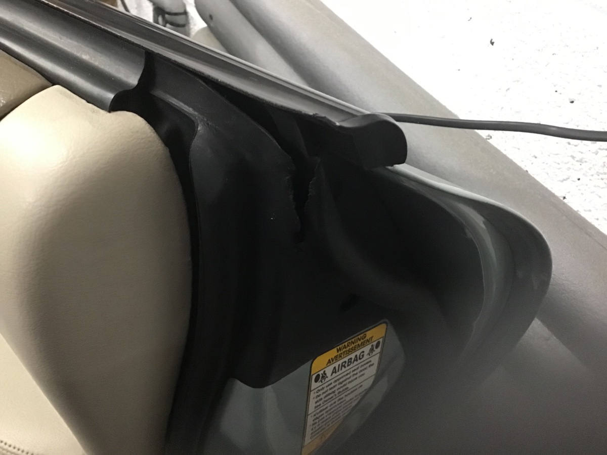

I have a XK8 (X100) convertible I have noticed that the door rubbers have split where the window comes up.
I don’t know why this is happening as the glass seems to be rising and dropping correctly. Has anyone also experienced this? I am loathed to replace the rubber seal, if the glass is likely to do the same. Is there any cure for this?

All rubberised seals suffer from UV light deterioration, the rate of which is dependent upon their exact composition, and that's probably the case for your seal which after 20 years service has become slightly brittle before splitting. There are rubber seal treatments available which claim to slow the deterioration and keep the seals in a more supple state. Hence, it may be worth trying one to preserve the other seals on the car. I have a vague recollection that Jaguar may even have recommended using one, when the XK8 was launched, with its reliance on expensive window seals bought in from Japan. Mike.

Hi Mike, Yes I have been introduced to a product called 303 Rubber Seal Protectant. I have used this on all exposed rubbers for the past three years. Unfortunately, the rubbers on the door/window had already split before I began using the product.

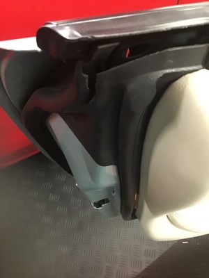

That particular piece often splits over time, and it’s part of the whole door seal, I think they may be available but expensive. My magazine article just referred to the section on the A pillar, which has rubber wrapped around metal and is an easy fix to replace. Mine is also split as per the pictures above, but as there is no leaks into the car I have decided to ignore it, for now…
