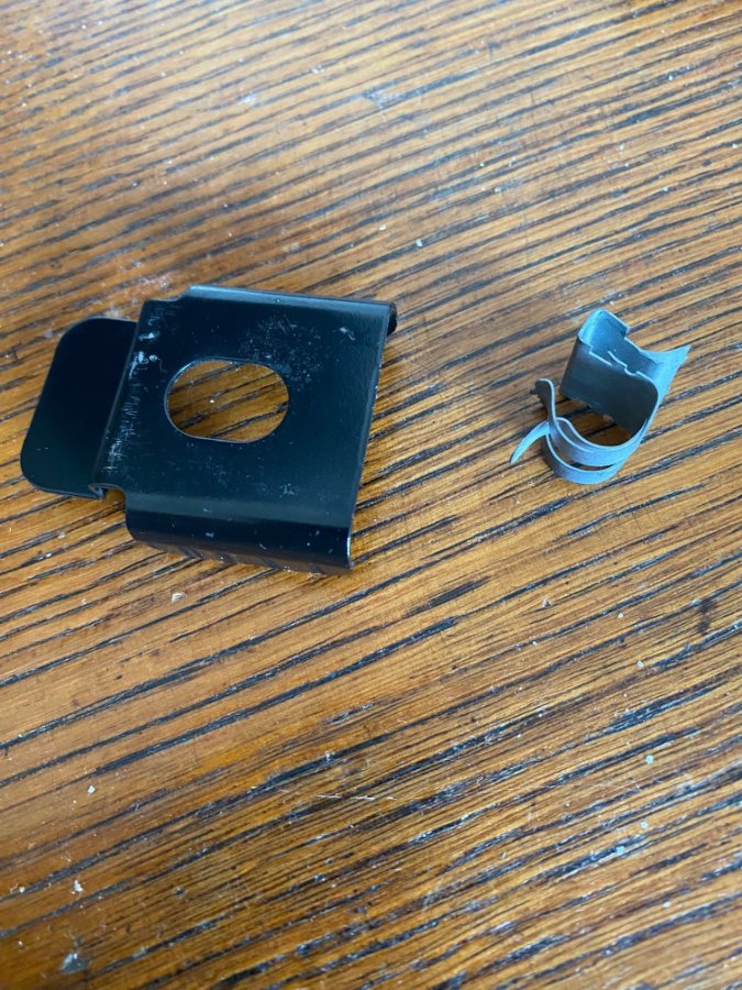

The only problem was a couple of stray components came away from the seat as I wrestled it out.
I am sure one is a cable clip to keep the loom from being trapped, but where should it clip?
And the other one looks like it is part of the mounting bracket.
If anyone has reference pics, or an exceptional memory I would be grateful!

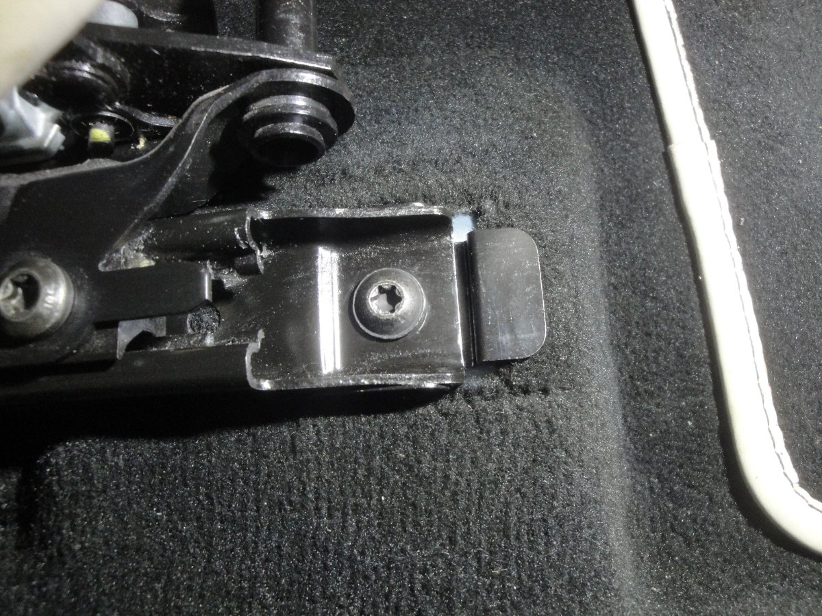

The bracket is one of four; one each at the front securing bolts for the two seats. They go between the seat frame and the floor.

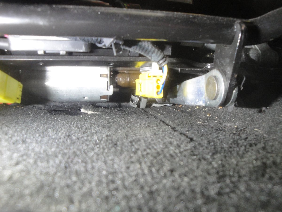

The clip holds what looks like the seat side-airbag harness - one blue, one yellow wire in the small yellow connector - to a part of the seat frame. It's further back from the yellow connector than it looks in the photo. Both seats are the same.
Here's a couple of photos that should help you

That's brilliant, thank you.
I will check in the morning. I assume the other 3 brackets must still be in the car, or missing! The seat has definitely been out before.

Thanks again for the reference photos. They came in very handy.
So I discovered that my seat only had one of those front mount brackets. The seat has obviously been out and one lost.
It's amazing how careless people can be when working on cars.
Should I be trying to find a replacement? At the moment one side is bolted straight through in to the floor, like the rears.

The only purpose of those brackets that I can imagine is that they hold down the edges of the carpet at those points. Without them, if the carpet rucks up, it's likely to get v messy when the seat is moved forward, gets caught up, either jamming the seat or damaging the carpet
