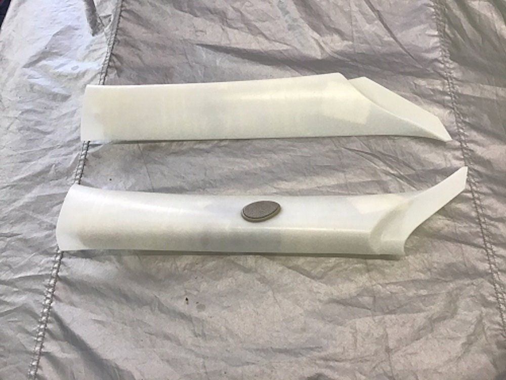

The 'A' pillars actually detach quiet easily using either 'brute force' or with a plastic spatula. Don't forget to unclip the sensor wire inside on both sides of the 'A' pillars. They do come out easily. The nearside with the speaker looking cover has a single screw holding it in place. Remove screw before attempting to wriggle the fitting out of the 'A' pillar. It has to be twiddled a bit but it will come out, just be careful. Once off, one can remove the nylon trim by pulling off the material then cleaning up the remaining glue using something like Evostik Adhesive remover. Once the plastic is cleaned up they should look like this:

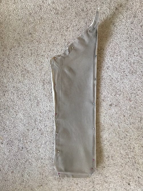

Then it's a case of using the old nylon material as a temp plate to use to cut out the faux leather.

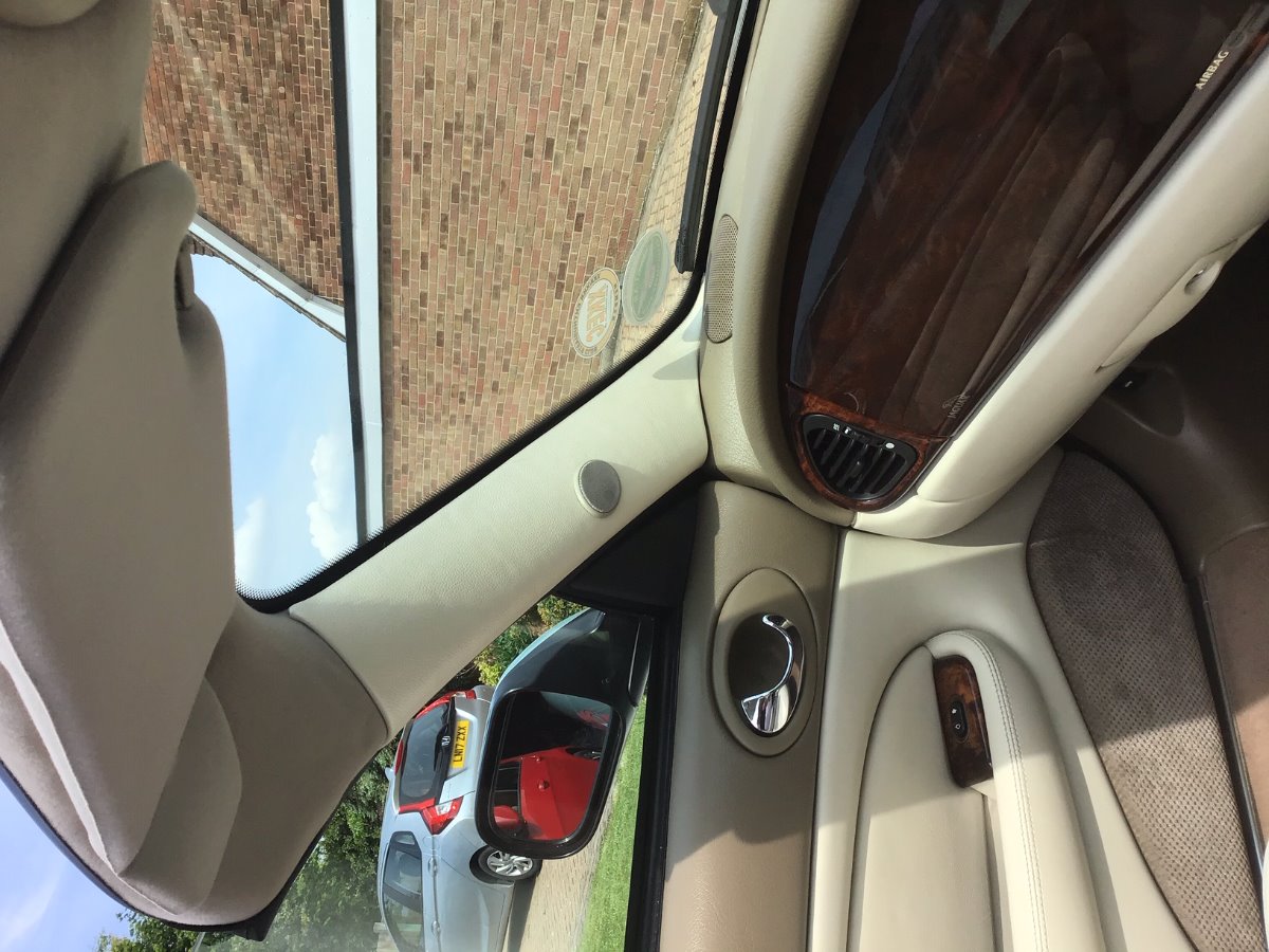

I am sure a proficient person can spray the whole 'A' pillar with glue then curl the faux leather around the post, but I found that by gluing one side first and letting it dry was easier for me. Then once dry, continue on with curling the faux leather around the post. Cut off any excess. One issue to not through is that at the bottom of the 'A' pillar, there is a recess. This needs to be kneaded carefully into the groove to prevent bulges. However, should you experience any, make sure they are below the recess as this will be covered by the dash once refitted back and will not be seen. The end result will be better than before by a mile. See photo! (Sorry its sidewards, for some reason I can't get it to be in portrait form. Not able to add more than three pictures too, which is annoying as I had more to show.)
