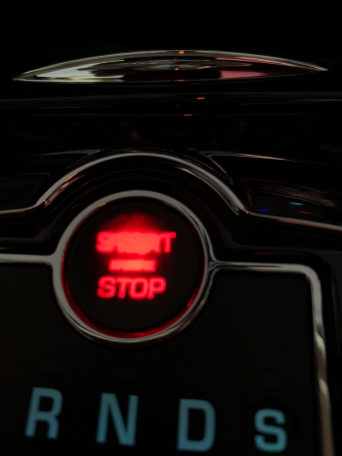

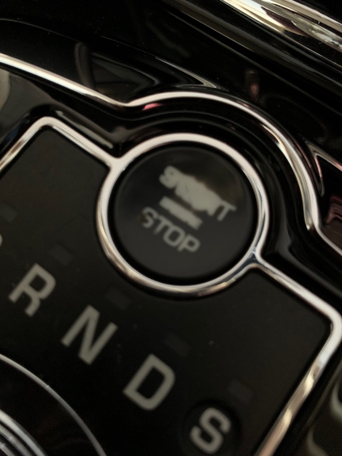

Having taken delivery of my 2013 XK, I immediately noticed the finish on the start/stop button has degraded. I looks like the script is blurred, although I'm not able to tell if that's been caused on the outside or inside. I've attached a couple of pictures - that's not my photography by the way - the writing is blurred not the focus!
Since it's something I see and touch every time I'm in the car, I'd like to replace it. My question is has anyone ever done that? If so, was it a straightforward process, and likewise would locating a replacement be easy? I was working on the assumption that it would be a fairly common Jaguar part so might be a bit more readily available than some other model specific items?

The starter button is still available to buy new (about £80), separately from the transmission control unit. The transmission control unit itself is held in place by four fixings which are accessible after the outer trim is carefully levered upwards. When replacing the switch, care must be taken not to damage the electrical connectors and control module housed under transmission switch. Mike.

What may be confusing the issue in this discussion thread is the absence of your car's VIN. Jaguar can supply a replacement starter switch (C2P15331) for £65.34 + VAT but it's only listed for XKs from VIN B26644 to VIN B32752. Whether it could be adapted to fit cars outside of this VIN range isn't clear. For later cars, Jaguar appears only to offer the complete transmission control unit at £664 + VAT! Mike.

I did say at the outset that it's a 2013 so that likely takes it into the realms of 'later model' I suppose. And to confirm, my VIN is B52115.
The starter button irritates me but not to the tune of £796! I think I'll learn to live with it or not look when I press it.....
